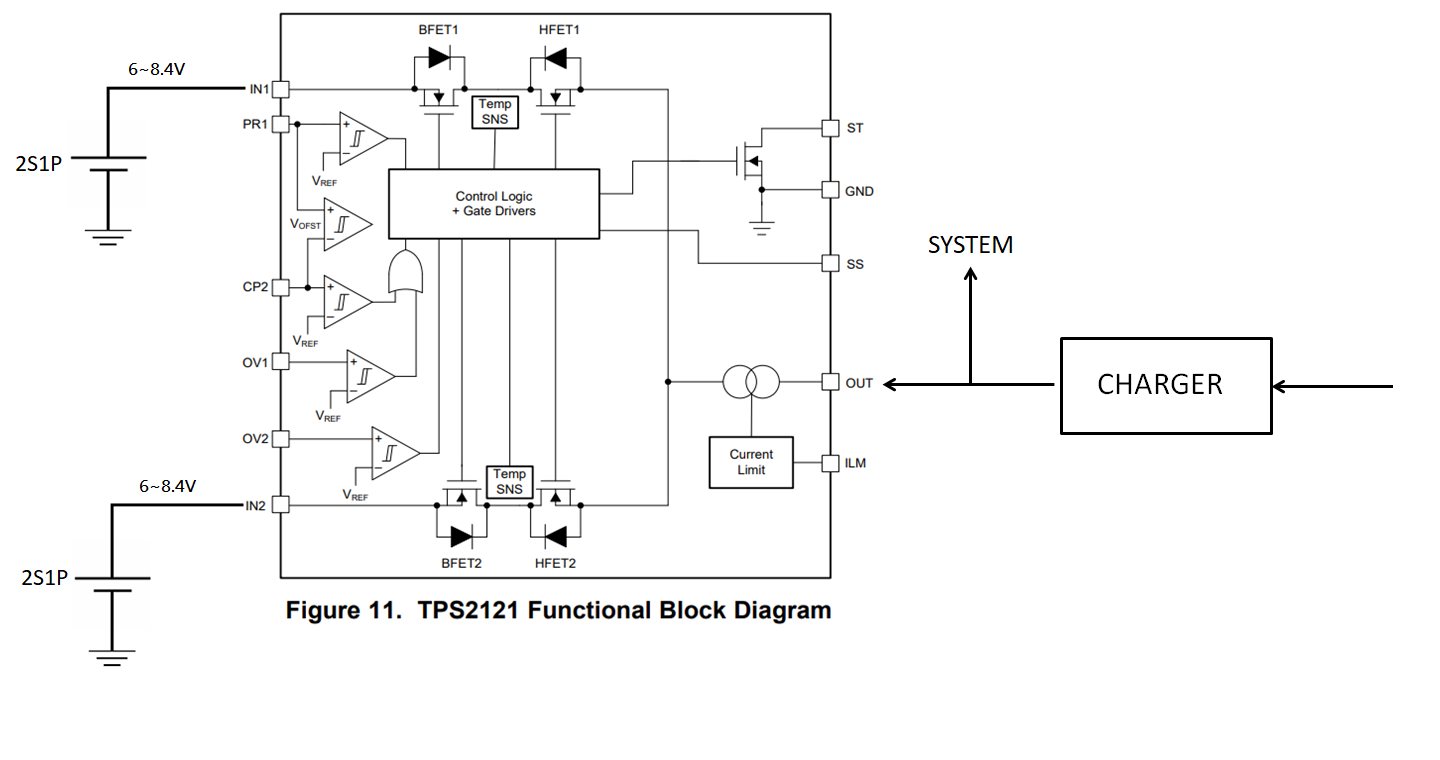

    Customer product using two battery pack to provide device power. When one battery pack SOC is empty then switch to another one.
Because the battery need charge and discharge ,the mosfet have two direction current flow. Is TPS2121 suit for this application?
