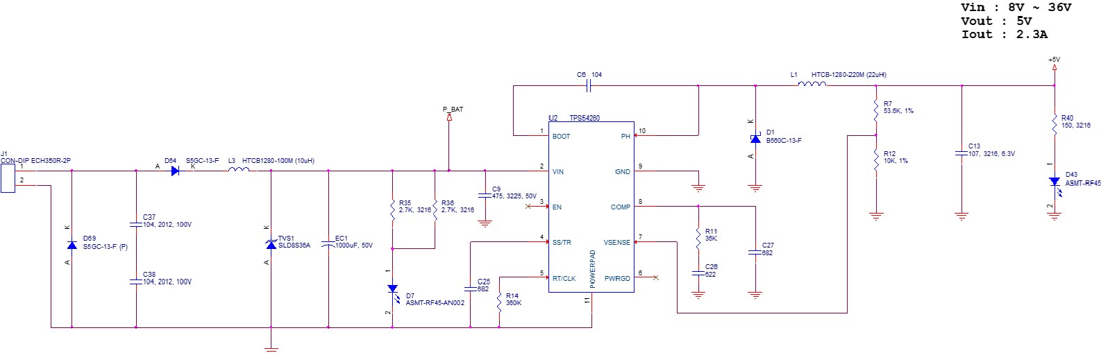

TPS54260 was designed using WEBENCH® Power Designer.

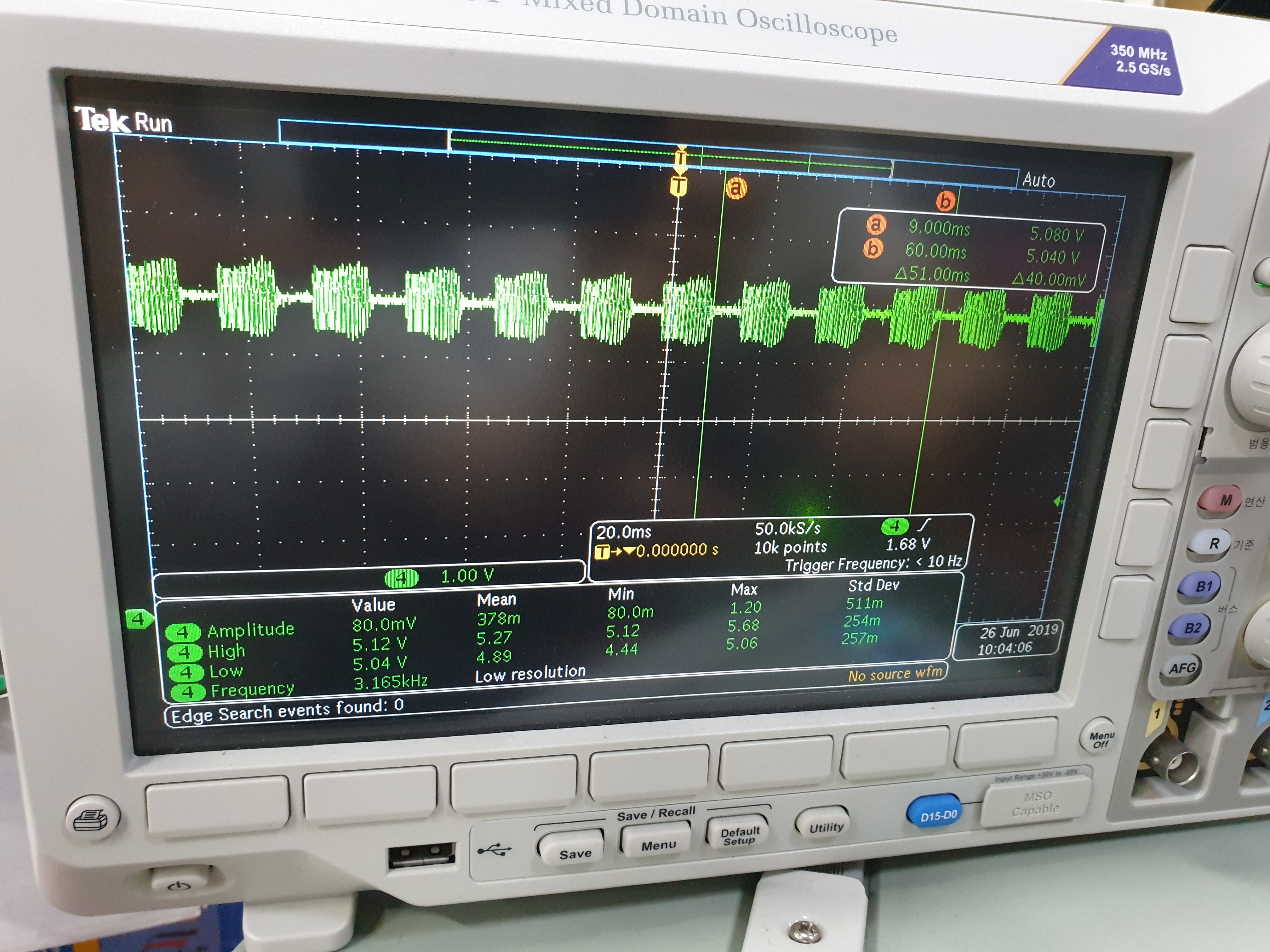

The output of the TPS54260 from several products is shown as a waveform of the attached picture.
The MCU is reset by the noise in the picture.(used reset ic : TPS3825-50DBV)
I want to know what the problem is.
A circuit diagram and photo are attached.
