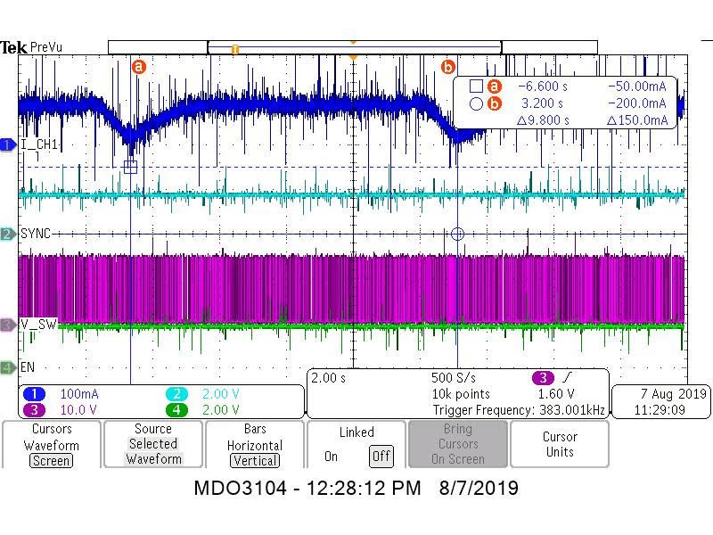

During the characterisation test of TPS61194
Test Conditions:
Input Voltage=12V
RIset = 49K , Rfset = 160K , PWM=100%, Feedback: R1= 470K, R2=130K
Vout = 15V, Iout = 50mA per channel.
Observation: Current Measured through Anode is going low every 9.8 seconds. Despite this drop duration being longer (About 1.5Seconds), we are not observing any perceivable brightness change in the LED brightness. Attached waveform for your reference.
Is this the expected behaviour? I couldn't find any mention in the datasheet about this.
