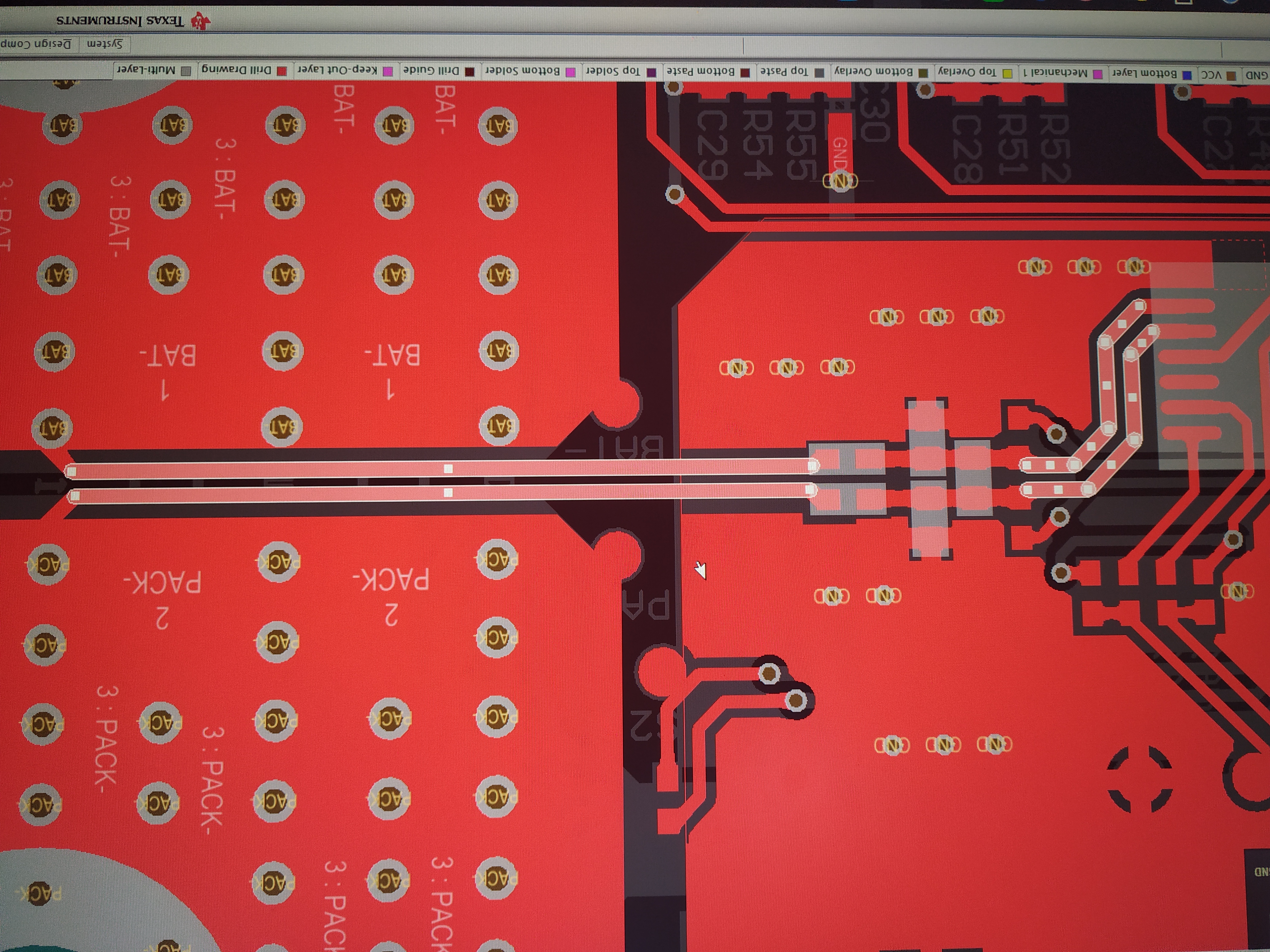

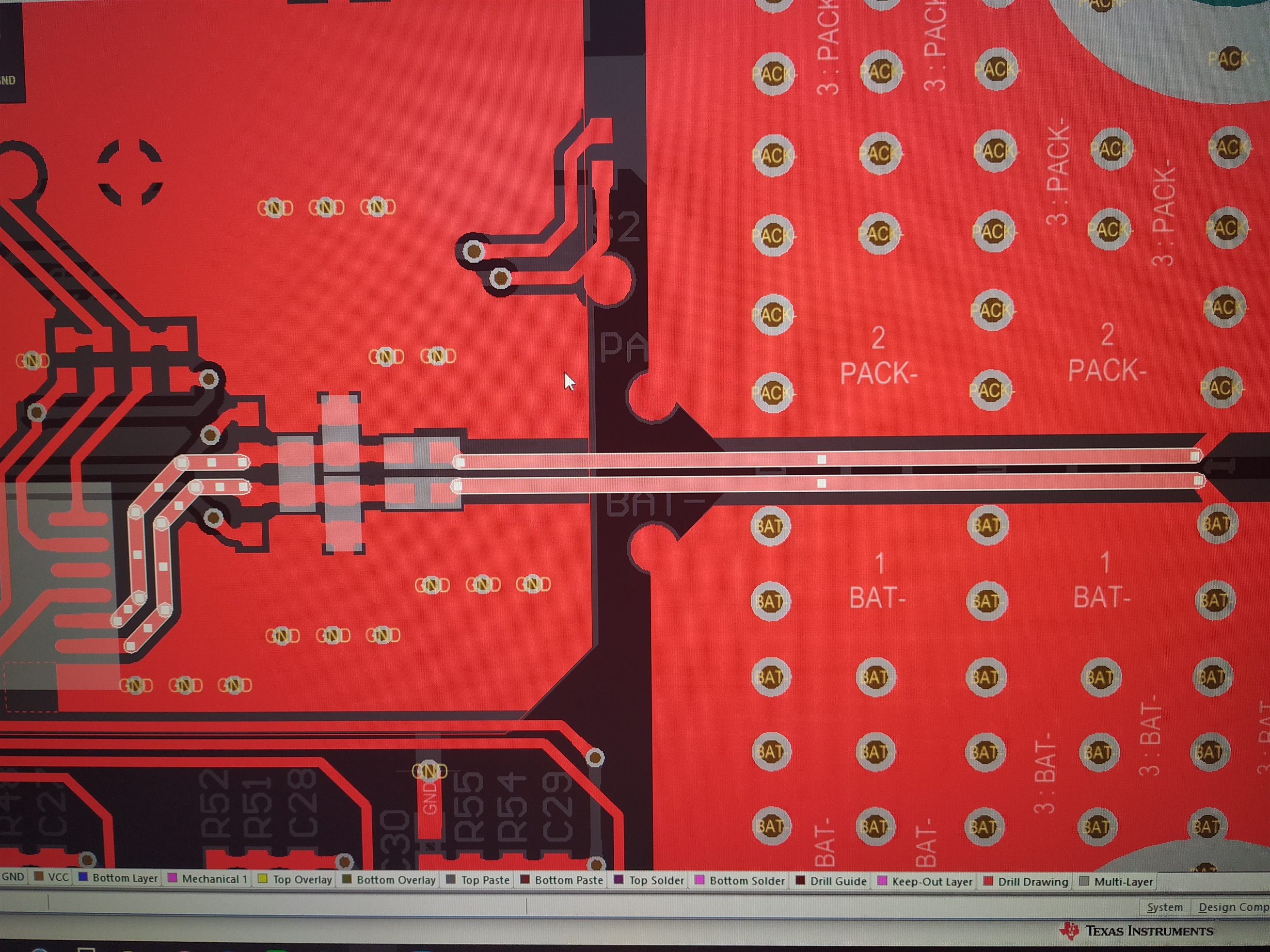

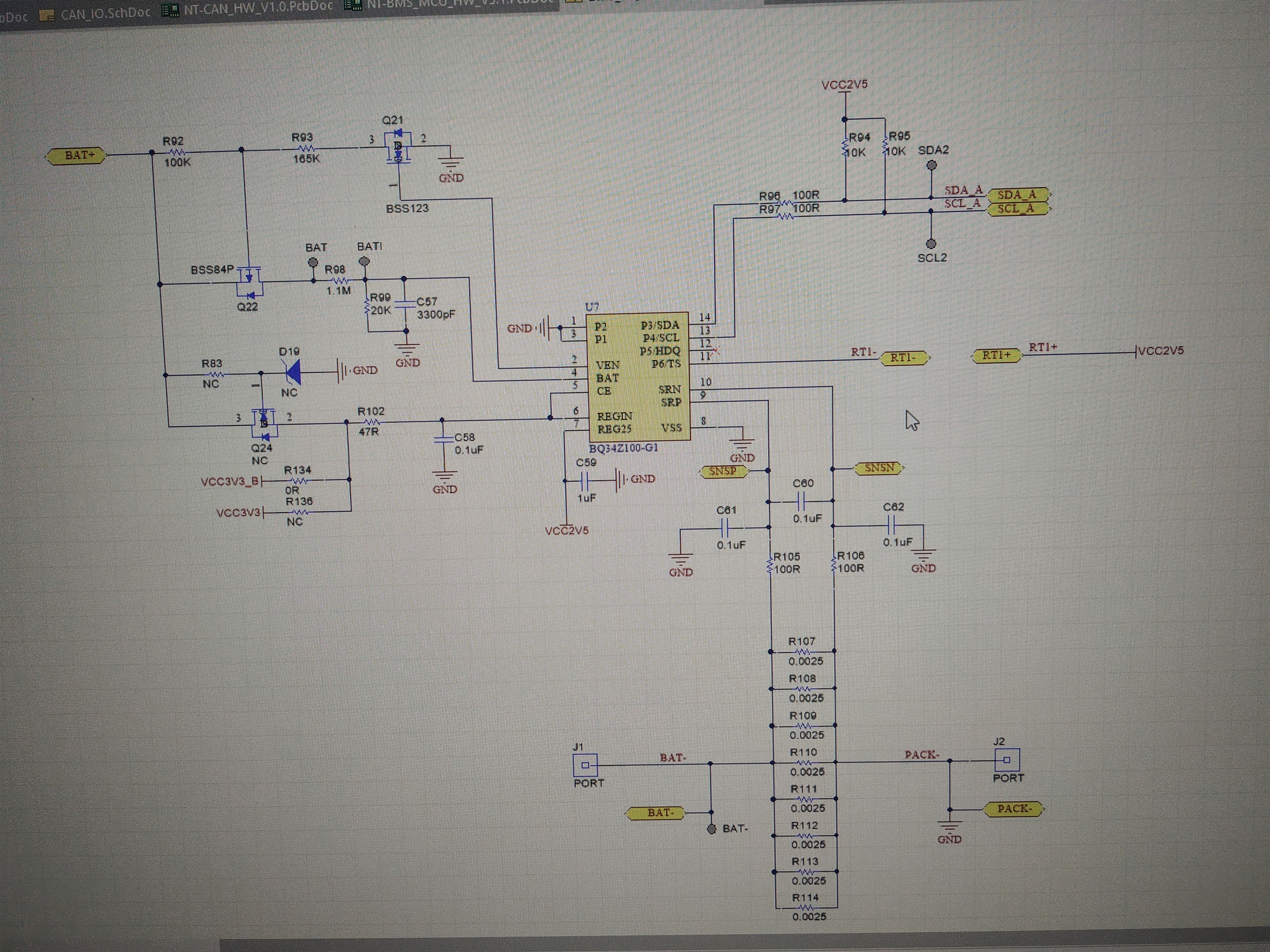

    Back to my first problem.The change in SOC is caused by RemainingCapacity's change.The change in RemainingCapacity is caused by Qmax Passed Q and DOD Passed Q .You sead  that Qmax Passed Q and DOD Passed Q will change when the gauge detects passed chg or dsg.But the log data show that there are no current during batteries's standing.Is there something wrong with my hardware circuit design?This problem has been bothering me for a long time.The product is about to go into mass production.So,I wish you can help me solve this problem.
    Attached hardware circuit and PCBLayout.

  • Hi Xie,
    You have used many sense resistors in parallel. This configuration is not supported and will lead to error. The bq34z100 supports a 10mOhm sense resistor. Please use that in your design. The chem ID 2106 is the best ID for your battery.
