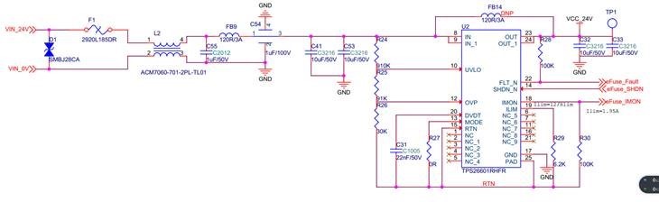

Hi TI
1:TPS26601RHFR Can TPS26601RHFR inhibit EFT fast pulse group?
2:If TPS26601 can inhibit EFT test, please help to check why we have EFT test but? thank you
Hello Wang,
Can you please elaborate on below points for inhibiting EFT fast group?
What is frequency (5-kHz/100-kHz) and amplitude of EFT pulses 0.5/1/2-kV)?
Is it required to stop EFT pulses from passing through the device (IN to OUT)?
Hi Ti
One question :
The EFT waveform, as defined by the IEC 61000-4-4 standard,the testing involves injection of EFT pulses
into the equipment’s AC power supply lines. The EFT waveform can also be injected into the signal and control lines,
and earth connections to simulate the coupling of transient noise onto these lines, For detailed waveform parameters,
please refer to page 5 of annex.
Two question
5khz/2kv
Three question
Yes, EFT can cause system instability, so we need to restrain EFT from entering the system.
Hello Wang,
TPS2662 and TPS2663 devices are better suited for protection from EFT Pulses (IEC61010-4-4). You can find test results with EFT pulses for these devices in below documents :
