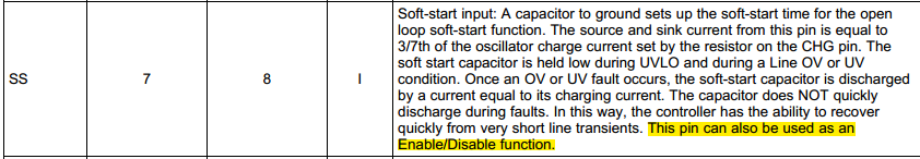

    Does this control IC provide output overvoltage protection? If yes, then how could it be achieved?
    Thanks and regards,
    Akshay
  • Hi Akshay,
    You can pull down SS pin to GND to disable UCC28220 when detecting the over-voltage of output.
    Teng
