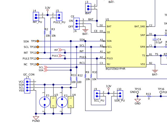

  • Hi
    I did setup with my system board chip to EVK board using SCL,SDA,GND I2C lines and connected with EVK board on J7 as shown in below image.
    But i was not able to read chip using bqstudio software. My system is having bq27z561 and battery connected to it, and i also disabled I2C interface between MCU and bq27z561.
    Is there any other hardware connection required so that i can read my system chip data using bqstudio?
  • If your host uC doesn't block the I2C (or issue traffic while you try to use the TI tool chain (EV2x00/GDK, bqStudio) then bqStudio should detect the gauge. You just have to connect GND, SCL and SDA. If you use a EV2400 or GDK then you don't need pull-ups on your board for SCL and SDA (these interfaces have pull-ups installed).
    J7 looks like it is directly compatible with the TI I2C cable so this looks good. Please check the voltage levels on SCL and SDA and if possible capture the traffic on SCL and SDA with a scope when you start bqStudio.
