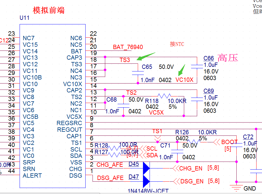

i met an interesting problem of BQ76940 in 12s battery and would like to get your help.
Firstly, i used an resister divider(4.7kohm) board as 12s battery cell. But i found the sampled cell voltage is not stable when i turn on NTC function(TEMP_SEL). When i turn off NTC, the sampled cell voltage is stable.
Then i tried to change the divider resister to 1kohm, i found the sampled cell votlage is still not stable, but getting better when i turn on NTC.
Then i tried to use actual battery cell, i found the sampled cell votlage is stable when i turn on NTC.
Do you have any comments for this phenomenon? Does the NTC feature consume a lot of current?

    The EVM uses 200 ohm resistors for the cell simulator resistor divider and the TS1 pin is only connected to Cell 1 when the BOOT button is pressed. On your board, is the TS1 pin always connected to Cell1? If so, this might be causing current draw through the filter resistors.

  • Hi Matt,
    No. Customer only use TS3. TS1 and TS2 are grounded with 10kohm resistor.
    Does the NTC feature consume a lot of current when it is enabled?
    what's the recommended sch if customer wants to use 1 NTC here.
  • Hi Hollis,
    Temperature measurements are taken every 2 seconds. The load on the supply pins can vary by +/- 165 uA = 3.3V/(10k + 10k) nominal at room temperature.
    The recommended schematic for the temp sensor is to follow datasheet figure 14. However, a small filter capacitor can also be used in parallel (see TI Reference Designs for exampes). The capacitor should not be used if there is no external temp sensor - it can cause issues with device start-up.
