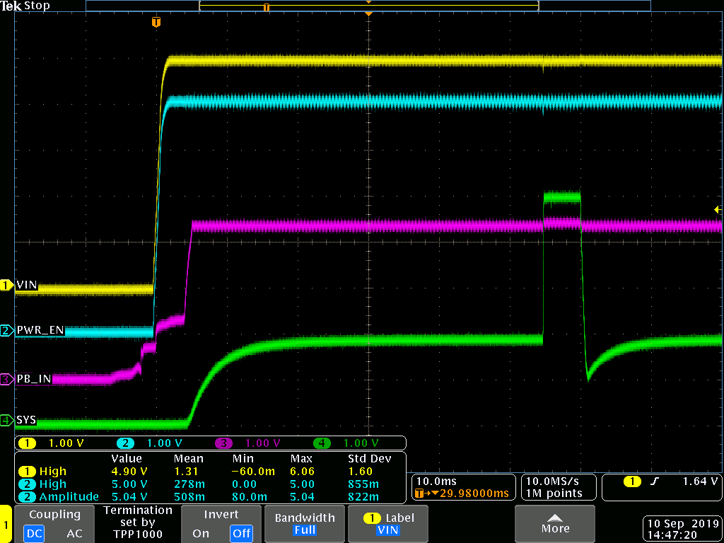

I see that the SYS output turns on but immidiately shuts down. I also see that all other voltage rails turn-on but shuts off after SYS goes down. Below is a capture of VIN, SYS, PWR_EN & PB_IN pins.

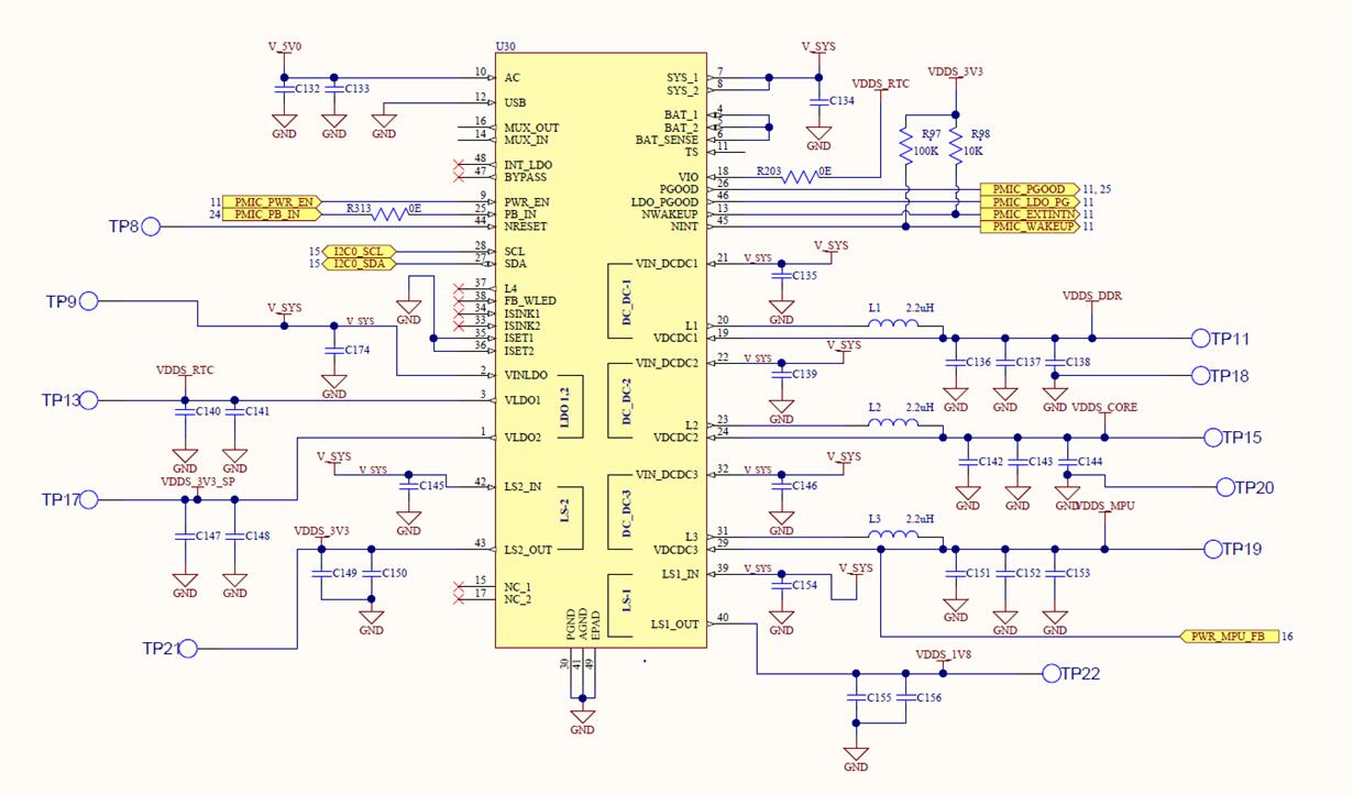

Below is the screen shot of the schematic
(Please note that INT_LDO & BYPASS have been connected to GND via recommended capacitors on the board).

  • Please monitor each rail as they begin to power-up:
    1. LDO1
    2. DCDC1
    3. LDO3
    4. LDO2
    5. LDO4
    6. DCDC2 & DCDC3
    It looks like you either have a short on one of your rails or INT_LDO and BYPASS are not connected as well as you think.
    The PWR_EN deglitch is 50ms, and the PGOOD deglitch for each rail is 4ms/2ms (DCDC/LDO), so by my estimate it would be DCDC1 that is not powering on as expected.
    INT_LDO and BYPASS pins are critical to the operation of the device. If you can measure the voltage on these pins, you need to verify that BYPASS = 2.25V and INT_LDO = 2.3V

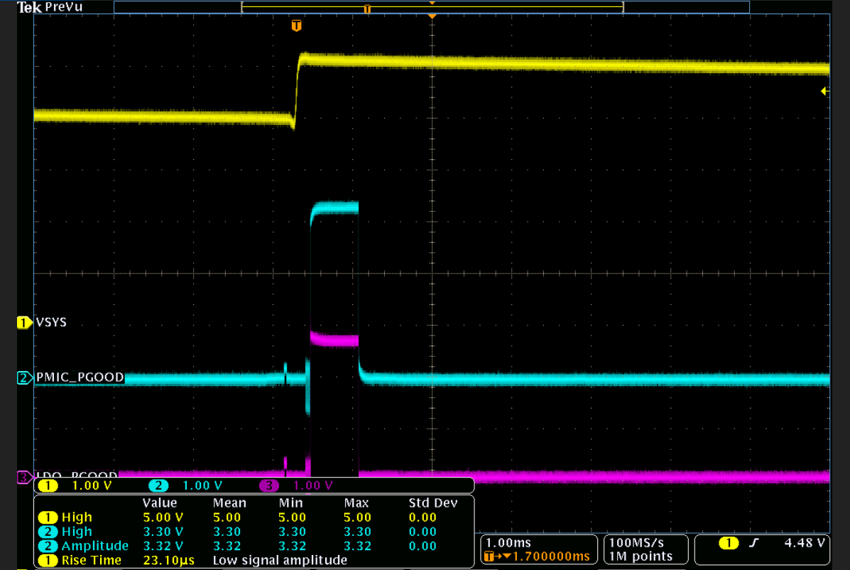

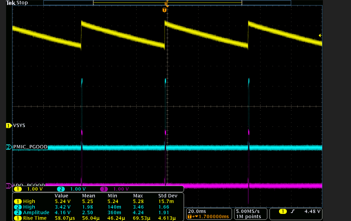

    I now have a board that has all the up to date re-works and here is how the VSYS looks like with respect to the two PGOODs.  Earlier the VSYS used to drop to +1V, now it is dropping to to about +4V and tries to combe back after about 50mS (both the PWR_EN and the PB_IN are high all the time).  Does this look like a start-up issue or over current fault? I measure good impedances across all the PMIC output rails.
    Is there a way to confirm the PMIC is out of OFF state and into ACTIVE state before shutting off? Also, I do not see voltages on any of the PMIC DCDC outputs.  I do see voltage output on VLDO1 and LS2_OUT.

    I have identified another mistake in the schematic that could be causing this issue to occur.
    If you refer to the TPS65217x Schematic Checklist, it says:
    • ISET1/2 = Float if not used
    • ISINK1/2 = GND if both are not used
    But your schematic shows these connections backwards (ISET1/2 = GND, ISINK = Float).
    I am not sure if this is the cause of the problem, but there is some evidence that this is a bad idea. If you refer to the ILED equation on page 38 of the TPS65217 datasheet, it shows:
    • ILED = 1048*1.24V/RSET
    With RSET = 0V (GND), you are dividing by 0. Although this may not cause a short (because L4 and FB_WLED and floating, it may cause an issue that is leading to this reset loop you have encountered.
