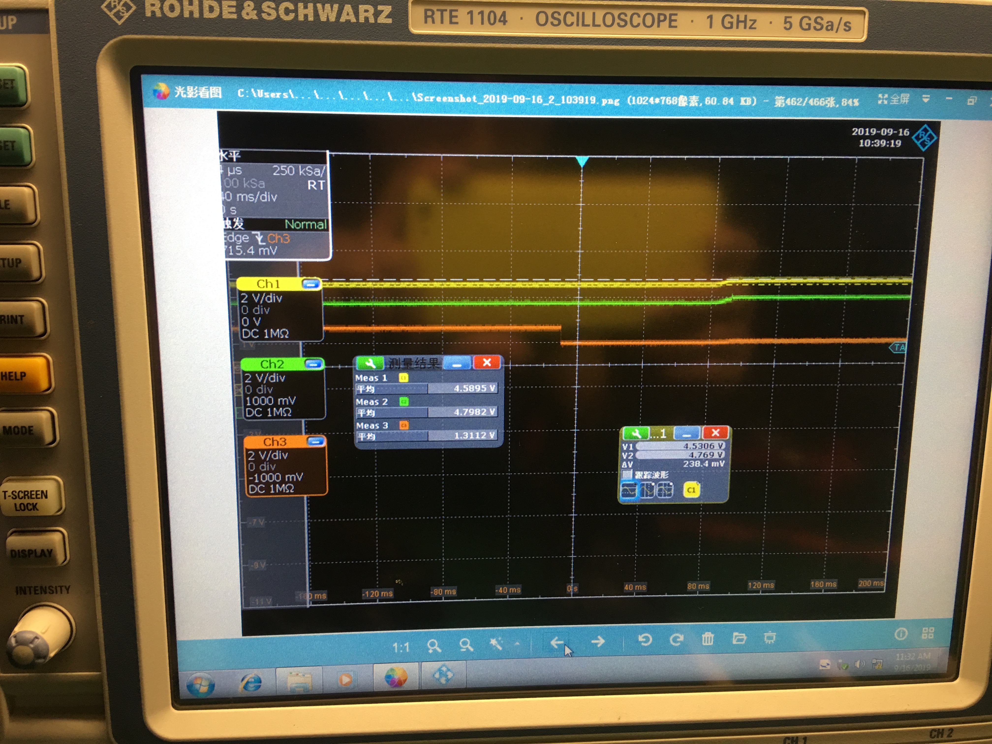

  • Hi,Shreyas Dmello
    I tested the RPI,IN1 and Vout with the oscilloscope.
    The test results are shown in the picture. IN1 and IN2 exist together
    CH1:Vout
    CH2:IN1
    CH3:RP1
    If only IN1 is used,the RP1's volotage will be normal,about 1.8V
    But if IN1 and IN2 exist together,the RP1's volotage will be change from 1.8V to 1.0V
  • Hi Weifeng,
    In that scopeshot not only does it look like PR1 is dropping when IN1 is stable, it also shows IN1 rising with VOUT after the switchover I presume. This could be because of no current being pulled from this source now which makes sense.
    I am looking into the PR1 drop. This is not expected behavior. What is CP2 in this case? Or IN2? I would say that something is off with your setup because it looks like PR1 is being externally pulled down!
