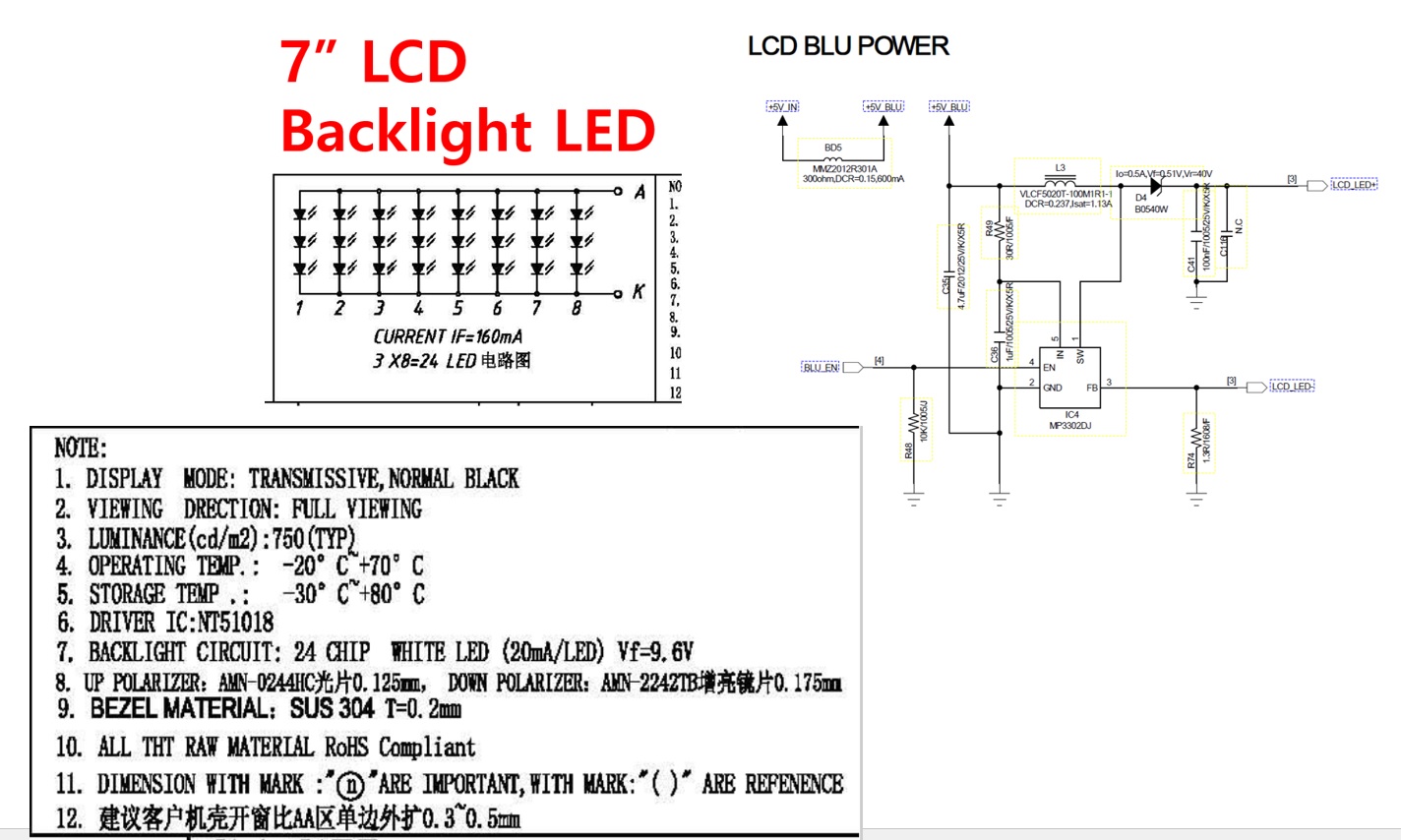

TPS61500: Schematic Review
Part Number: TPS61500
Other Parts Discussed in Thread: TPS61165
Dear TI,
We are reviewing the LED Driver ICs that will be applied to the signature wall-mount 7inch LCD.
In the existing MP3302DJ (MPS), there was a problem that the LCD panel flickers occasionally at 100% brightness.
Using TPS61500, the circuit diagram is composed as follows.(Current of Backlight LED is 160mA)
Is there a problem in circuit design like this?
I need your help.
