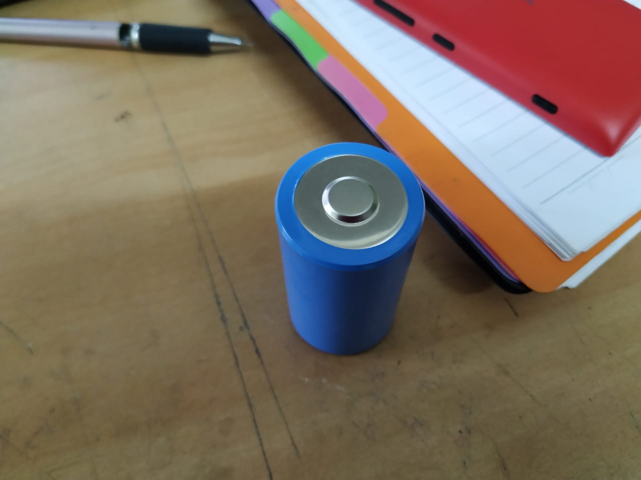

Rightnow I am working on Fuel Gauge Ckt Designing of our IOT applications using BQ35100 IC.
We had purchased the bq35100EVM-795 Evaluation Module along with EV2400 Interface module.
And testing it on the battery management studio.

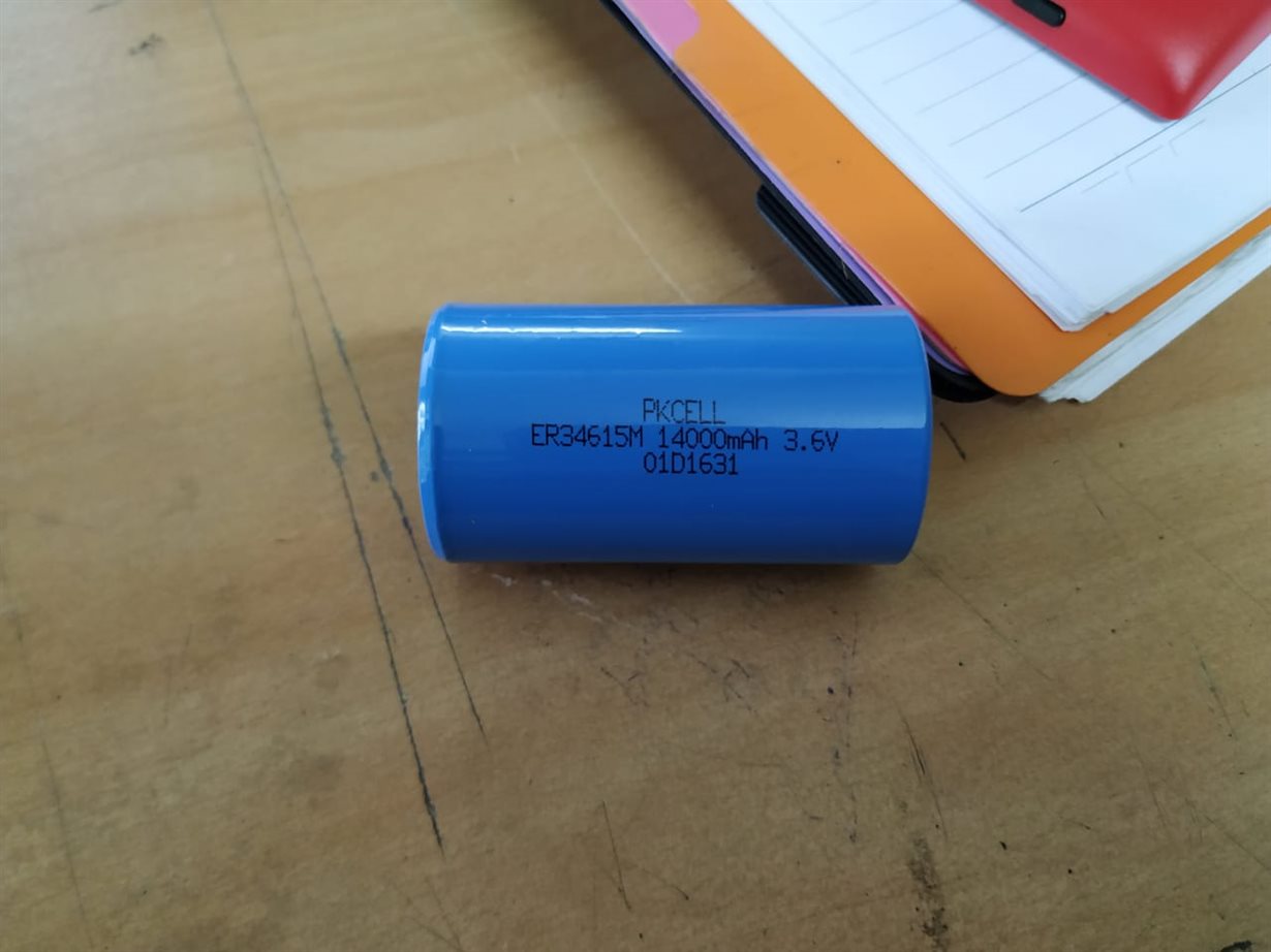

We had purchased Primary Lithium Thionyl Chloride Battery from the PK CELL of Model No:-ER34615M 14000mAh 3.6V .

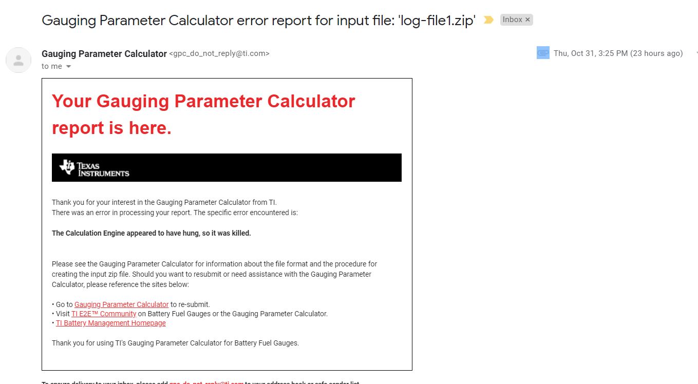

Now our problem is that the we are not able to programme the cell chemistry of our cell in BQ35100 IC ,because our cell is not listed in Cell Chemistry section of
Battery Management Studio. So will you please suggest us solution for this
I am attatching here technical specification sheet & also some Images of our cell.
