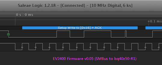

EV2400 Firmware: v0.28 (previously v0.05)
bqStudio v1.3.86 Win7
ICs:
- bq34z100-G1 I2C (working)
- bq40z50-R1 SMBus (not working anymore)
When trying to fix another bug, I came across the possibility that the firmware of the EV2400 was too old. But after updating the firmware from v0.05 to v0.28 I can't connect to the bq40z50 anymore!
I have already performed the following tests:
  • Hooked up my saleae and get valid addressing + ACK as I also got with the old firmware version (see screenshots for both versions below). So wiring is not the problem.
  • The setup worked 5 minutes ago.  So gauge parameter programming are not the problem.
  • Putting the bq40z50 into the device I built, the bq40z50 responds and works.So the bq40z50 is still alive and is not the problem.
  • A battery with a bq34z100 connected to the EV2400 via I2C is still working. So it's not a Windows / driver problem.
A) Is there an option in bqStudio I missed to set?
B) Is there a way to downgrade my EV2400 to an older version? (on the EV2400 page the download link for V0.18 redirects me to v0.28)
