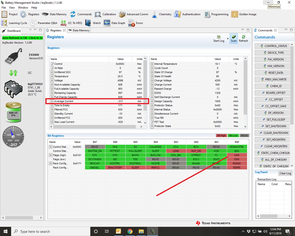

I am observing a confusing issue with the eval board. See attached screen shots showing charge and discharge. This is my second eval board.
When I am discharging both FETS(DSG and CHG) are on. When I an charging only the CHG fet is on. I do not understand why the DSG FET is not also turned on when I am charging. If it is not turned on, then the charge current has to go through the DSG FET body diode.
Any ideas or help from any experts would be appreciated. Thanks in advance, Mike
