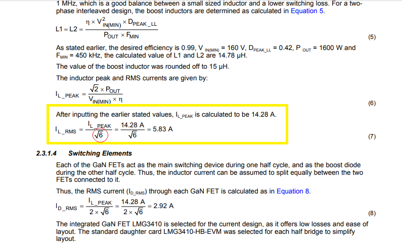

I am troubled that current calculations, boost inductor, switching elements.
Please tell me how to calculate this current.
Also, please tell me how to derive the formula.

please refer to the TIDA-00961 design guide equation (7) and equation(8)
http://www.ti.com/lit/ug/tidudt3b/tidudt3b.pdf
it assume the inductor current is triangle wave (without negative reverse current),
and its average value of each cycle is same with the sine wave of input current at that line phase.
and its average value of each cycle is equal to the sine of input line phase.
you want to understand how to get it, may need to derive it by yourself, If you just want to double check the equation, you can do it by simulation tools.
