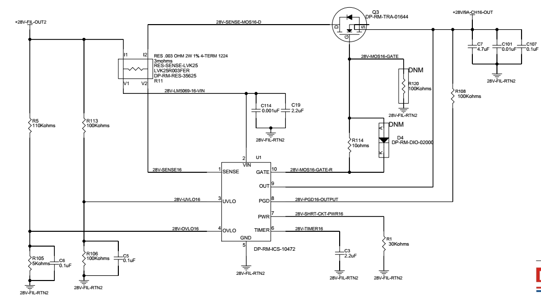

We have used LM5069MM-2/NOPB for OV/UV & Over-current protection IC and need some clarifications on this.
Following are the values chosen in the Circuit;
Rsense = 3 milliohm
Undervoltage threshold = 5V
Overvoltage Threshold = 57.5V
Resistor at PWR pin 30Kohm
Capacitor at TIMER pin = 2.2 uF
Vin Max = 28V
Test Conducted: Short Circuit (Applied Input Voltage to IC = 28V / 18A)

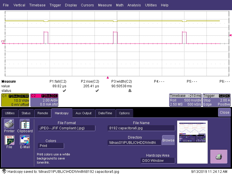

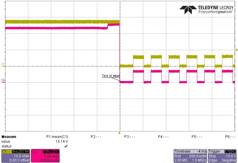

But in our observed case, only 3A current is allowed during fault timeout period of 103ms. Observed load current graph is attached here. (second picture)

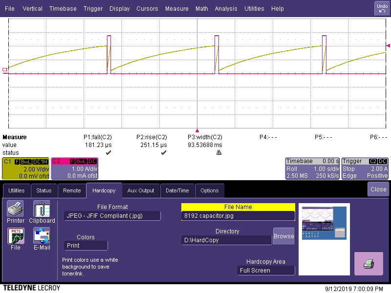

But in our case, restart time of only 2.75 seconds is observed. Also seven cycles of timing capacitor charging & discharging is not observed, only one cycle exist between the two fault timeout period. Observed load Current & Timing capacitor voltage graph is attached here (Iload-Vtimer.jpeg).
3. Restart time of 1.45 seconds is observed while probing load current & MOSFET Vds. Why is this two different restart time is observed while probing one case MOSFET Vds & load current and other case Timing capacitor voltage& load current. Observed result is attached here ( 1st & 2nd picture).

  • Hi Balaji,
    Can you please share schematic, layout files and filled up design calculator. The design calculator is available at http://www.ti.com/product/LM5069/toolssoftware
    Instead of step-load, can you check by increasing the load current gradually where the controller trips.
    BR, Rakesh

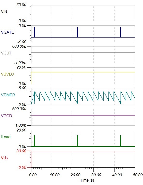

    Schematics is simulated under short circuit condition using TINA-TI software and observed result (Restart sequence and Load current during fault timeout period) is attached here.
    From the simulation result, it can be observed that our prepared schematics gives expected result.
    i.e. 1. Short circuit Current (14A) is allowed during fault timeout period. But our chosen Rsense value should allow 18.33A as per the datasheet information (55mV/3milliohm).
    2. Seven cycles of Charging and discharging of timing capacitor occurs for restart time of 19.8 seconds after fault timeout period.
    During restart time MOSFET is kept off as mentioned in the datasheet.
    But when schematics is tested in practical the above points is not observed (results are attached in the previous message).
    Kindly clarify the reason and give solution.

  • Dear Sir,
    Power limit set value is 89.3W (Calculated using Equation 9 given in page no:20 of LM5069 datasheet)
    Rsense= 3milliohm
    Rpwr= 30000 ohm
    Vds= 31.5V (Vin max)
    Schematics is tested by gradually increasing the load current, it trips at 18A as shown in below figure. But after fault timeout period (100 ms), restart time of 19.85 seconds is not observed.
    Schematics is also shared here. Kindly clarify the reason for
    1. why there is no expected restart time (19.85 seconds) is observed.
    2. During fault timeout period only 3 A is allowed instead of allowing 18.3 A (for selected Rsense=3 milliohm) under short circuit test.
    Manufacturer part no of MOSFET Q3 is PSMN4R8-100BSEJ
    DNM represents DO NOT MOUNT Components

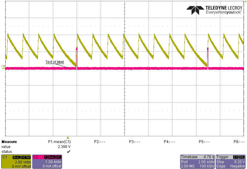

  • Dear Sir,
    When schematics is tested by gradually increasing input voltage from low voltage to 31.5V & above, result observed is as expected.
    But when it is tested with input of 31.5V & above (at start itself), LM5069 asserts the condition as fault & restarts with time interval of 10.8 seconds.
    Actually there is no fault,i.e 1. set value of undervoltage & overvoltage is 5V & 57.5V respectively. 31.5V input voltage is within the limit.
                                                     2. Load applied is 3ohm, so load current will not be exceeding 10.5A (31.5V/3ohm). Load current(10.5A) is within the set limit 18.33A(55mV/3milliohm).
                                                     3. Also Fault is not due to set value of MOSFET power limit. Pmosfet= Vds*Ids [Vds=(Rdson=4.8milliohm)*(Ids=10.5A)] ; [Ids= 10.5A] So Pmosfet will not exceed 0.529W.
    Then Why LM5069 asserts the condition as fault eventhough there is no fault condition. Observed result is attached below (yellow-Timing Capacitor; Pink-Load current)
    Kindly clarify the above observation.
  • Hi Balaji,
    With Power limit of 89.3W and at Vds= 31.5V, the device limits the current approximately to 89.3W/31.5V = 2.835A during recovery from overload fault.
    What is the load when you directly apply 31.5V. It has to be <2.835A to make successful startup.
    Are you sure about the timer cap value? Is it electrolytic or ceramic type ?
    BR, Rakesh

  • Hi Balaji,
    The device operates in power limit mode during startup, restart mode (recovery from overload fault also) where the VDS across the external FET is high (close to full Vin voltage).
    But when input of 28V is applied at start under full load condition (9A), 9A load current is allowed LM5069 successfully startsup & works fine. Here (89.3W/28V= 3.18A)
    What is the type of load? Is it 28V/9A = 3.111 Ohm ?

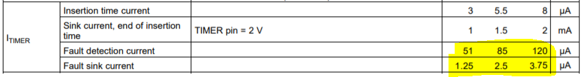

    We can expect some variation in restart time from device to device as the fault detection and sink currents has tolerance. Is it matching if you consider 120uA, 3.75uA values. ?
    BR, Rakesh
  • Dear Sir,
    Can you please elaborate how Vds is equal to Vinput under overload condition & startup mode. What I understood is that under overload condition, in series with MOSFET Rds, load resistance of 3 ohm is present. Maximum of Input voltage drops across the load resistance part (3ohm) than across Rds=4.8milliohm. So vds drop will be very less (not Vds is close to Vin right?) & maximum current (18.33A limited by Rsense) can be allowed without crossing Power limit threshold.  If i am wrong, then how for 28V/9A (under full load condition= 9A) startsup successfully & works fine  ?
    Resistive load (3 ohm)
    We can expect some variation in restart time from device to device as the fault detection and sink currents has tolerance. Is it matching if you consider 51uA, 1.25uA values. ?
    Considering fault detection & sink current tolerance, for chosen 2.2uF timing capacitor;
    Typical Restart time : 19.85 Seconds
    Minimum Restart time : 13.259 seconds
    Maximum restart time : 39.55 seconds
