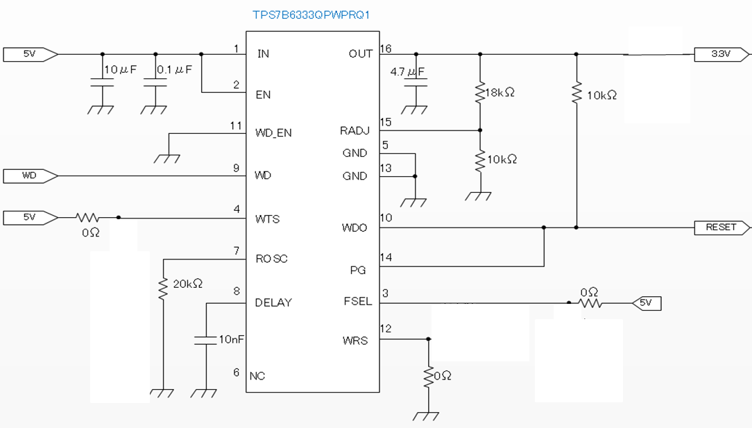

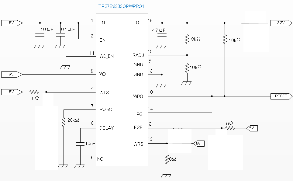

Hi Team,
My customer thinks to apply attached pin configuration.

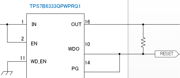

- Wiring OR connect with WDO and PG
- Connect WD_EN to GND
- Configure as Standard WD mode
- Reset MCU while PG = Low or WD Timer out event.
(1) In case WD_EN is connected to GND, will WD Initialization start just after PG shifts to High state?
(2) With Standard WD mode, is it OK WRS port connecting to GND?
