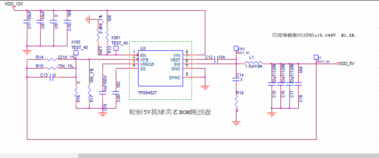

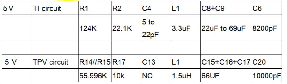

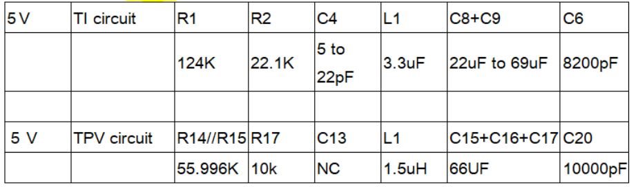

Hi Team,

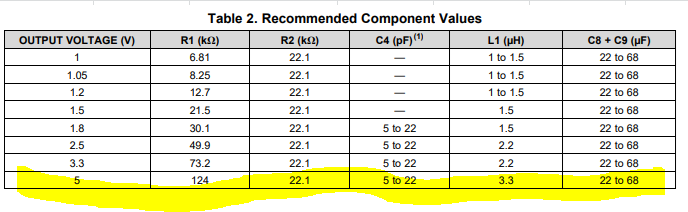

Customer is designing TPS54527 with 5V output. However, the customer design circuit is different than table 2 recommended component values.
Would you please review customer schematic and provide your comment?

SSH,
I would recommend following the recommended componnet values. Why are you deviating from them?
