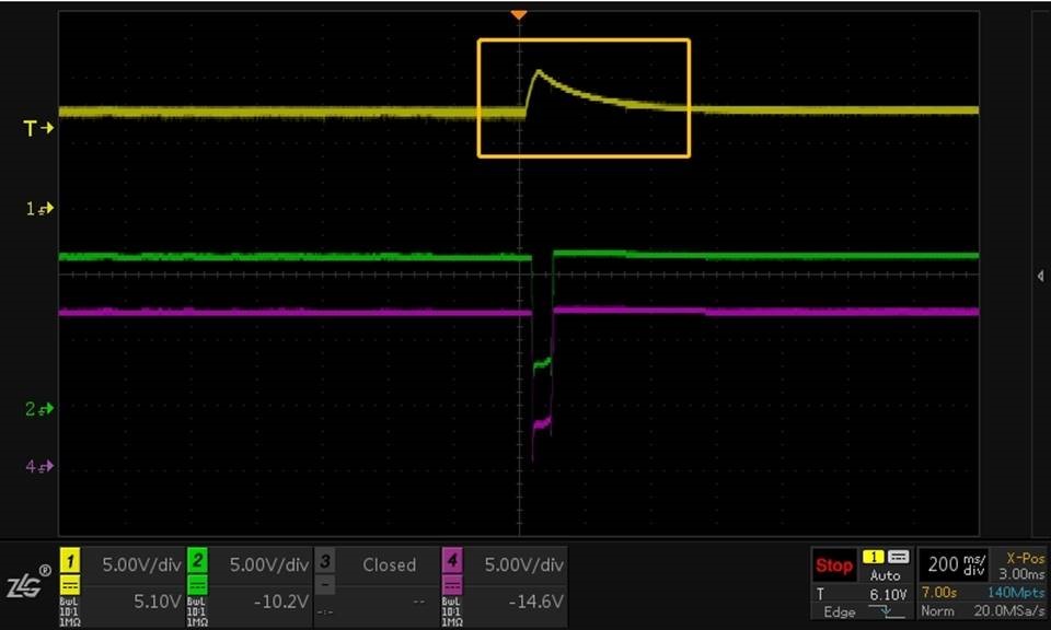

 When enter system to desktop, the adapter to system-vcc power down one time. the below is the ACDRV# of waveform . if havegood advices for the issue. thank you!

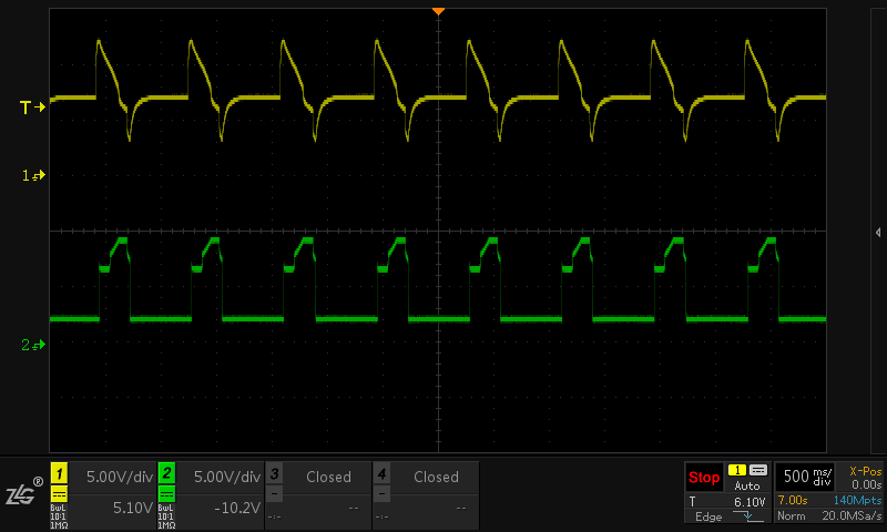

The below are the  ACDRV# and ABTDRV# of waveform when adapter and battery exist

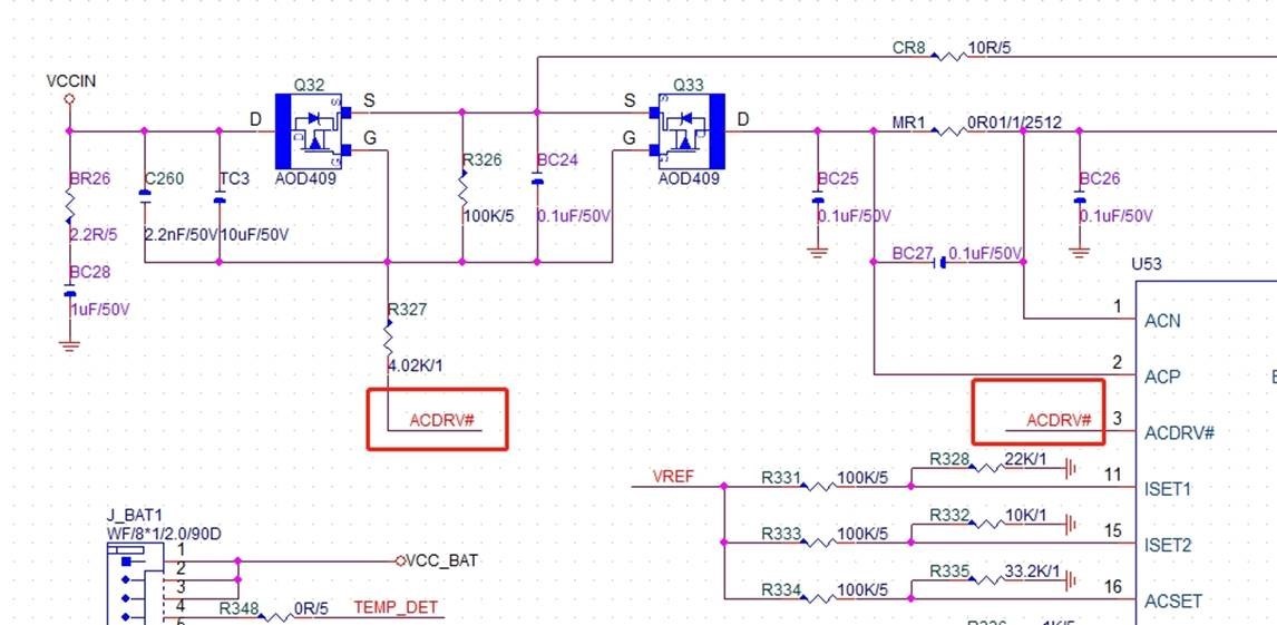

The below is the sch of BQ24610:

    Can you take a scope capture of VCC, ACDRV, BATDRV and battery current when desktop or input source is plugged in? What are CH1, CH2 and CH4 of first scope capture? For your application, you are looking to see transition between system being powered by battery and when plugging into adapter (desktop) so system is powered by VCC?
