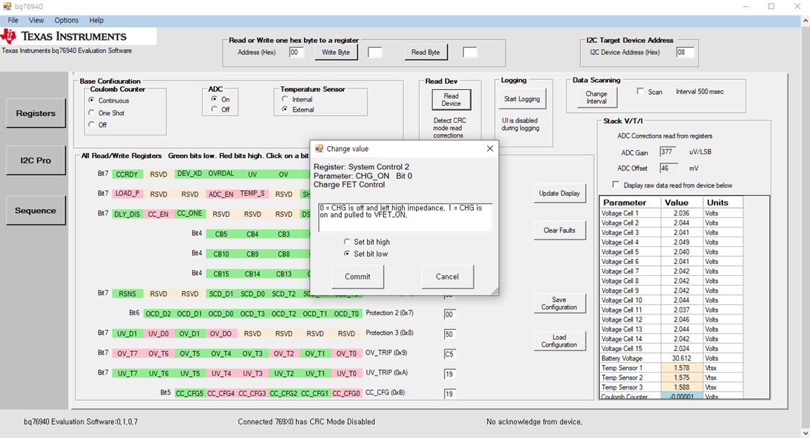

1. Connect DC Power Supply and input 30V voltage, but only 25V is checked.
   When change DSG_ON, CHG_ON setting, 30V is checked for a short time, but cannot maintain.
   Why this kind of symptom is occurred? and how can fix it?

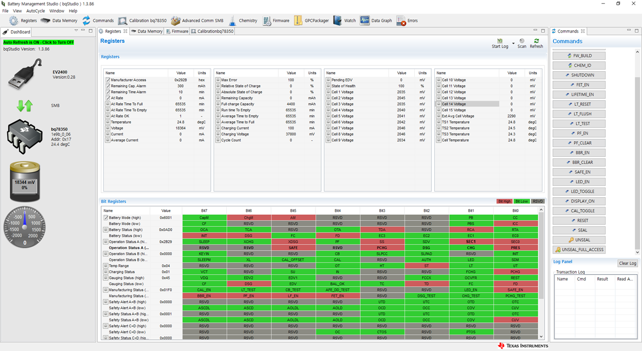

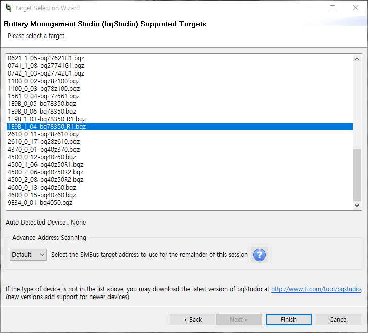

3. When using bqStudio, it seems that operates not correctly. Only 9 Cell voltages are detected.

    Be sure to remind the customer that the BQ76940 EVM can support evaluation of the BQ76940 only such as preparing for control by an MCU, or with the BQ78350-R1 gauge.  Both softwares are shown in the questions, but should not be used in the same configuration.
    1. A user might suspect the power supply is dropping with time.  Check the current limit or capability of the supply,  measure the voltage independently of the GUI display.  Also consider the note above, if both the gauge and the external software talk to the BQ76940, bus collisions can occur resulting in the wrong voltage.  The expected result of a bus collision would be bits being low, if voltage were being read it would appear lower.  If a bus collision occurs the BQ78350-R1 spends most of its timeline trying to talk to the BQ76940 and can make the observation consistent although the individual values may vary.
    2. Yes, when the power supply is applied or each time it is turned on the part must be booted.
    3. The BQ76940 is not capable of operating in a standalone mode, its registers must be loaded each time power is applied.  That might be done by a MCU in a final system.  For evaluation of the BQ76940 on the EVM a file can be prepared and run by the Sequence tool of the GUI, see the user guide and example files.  When operating with the BQ78350-R1 gauge it stores parameters for the settings to load the BQ76940 registers at each power cycle and has periodic checks of those settings.

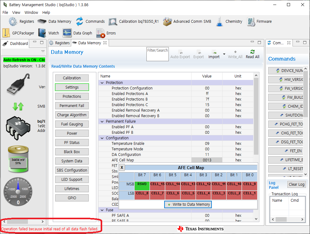

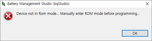

  • Hi WM5295,
    During BQ76940EVM TEST, set ROM mode when F/W UPGRADE. but failure occurred as below.
    And Flash failed is occurred during value input as below.
    At that time bq76940EVM and EV2400 connection is as below.
    Could you let me know why those failure is occurred and How can I fix it?
    Nicky
  • Hi Nicky,
    Often those type errors occur when the gauge shuts down before BQStudio sends the commands selected. To avoid this be sure to operate the EVM with sufficient voltage and when reducing cell count change the configuration before changing the connections.  See the EVM user guide http://www.ti.com/lit/slvu925 last paragraph of section 6.4.  With the EVM it is easy to simulate a charge current to prevent shutdown by applying a few mV to the SRP test point.  With the charge current the part should stay awake after boot to reprogram or to change the configuration.
    If that is not it, please reply.

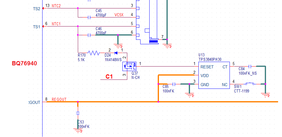

  • Hi WM5295,
    Will make boot circuit for BQ76940 as below.
    Please check and let me know if it can be applied.
    Nicky
  • Hi Nicky,
    It seems reasonable, a couple things to check would be the load on the thermistor and the Vgsth of the N-ch FET.  Be sure you can get above 1V with various temperature conditions of interest and voltages of the battery.

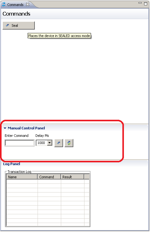

  • Hi WM5295,
    Could you let me know how can show up below Manual Control Panel?
    I cannot find this panel.
    Nicky
  • Hi Nicky,
    The Manual Control Panel is no longer available. The Advanced Comm SMB window can be used to send commands.
