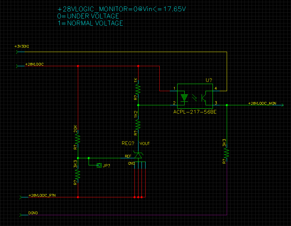

I would like to use the TL1431 as a window comparator as depicted in Figure 34. Voltage Monitor of TL1431, TL1431M  SLVS062N datasheet.
The main issue is the voltage that I should monitor. It is a +270Vdc. Any suggestion please?
Ciro

  • Hi Marcoo,
    of course I can better describe the system.
    I have a +270Vdc supply and I need to fix two thresholds in order to detect respectively OVERVOLTAGE (+365V) and UNDERVOLTAGE (+220V) conditions.
    I already used the TL1431 as depicted in the picture below:
    when the +28VLOGIC supply is greater than 17.65V then the photocoupler is turned on and the +28VLOGIC_MON signal is at HLL (3.3V)
    I would like to use the same approach for the +270V rail with two thresholds as described above.
    -Ciro
  • Hi Ciro,
    if you need the TL1431 to work at higher voltages you would need a step down. The cathode of the TL1431 cannot handle 270V in comparator mode when the output is logic high. You can use a 2nd TL1431 to create a step down voltage to 26V for the cathode.
