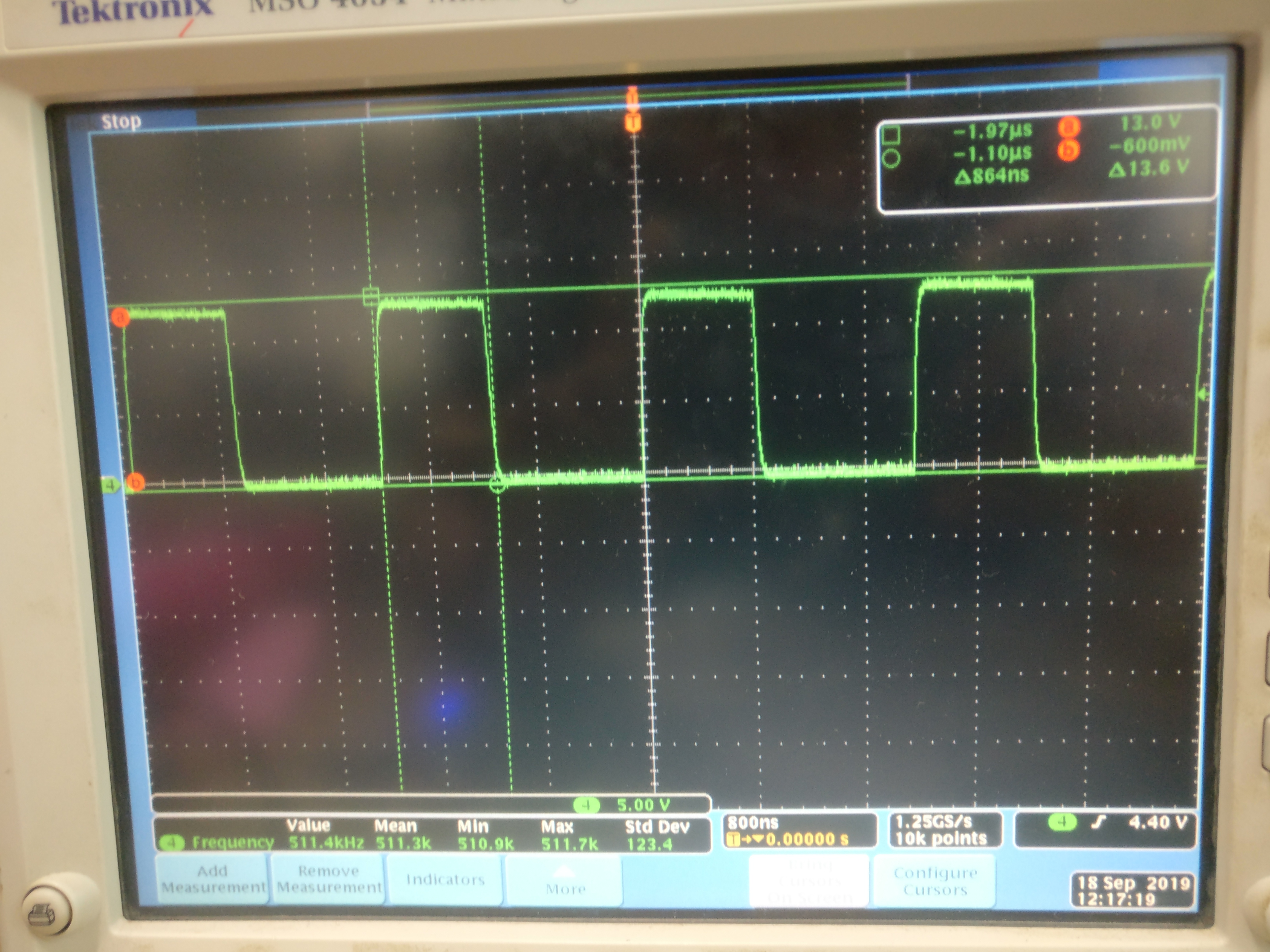

    On probing the PH pin of the regulator, We see ~512kHz with an ON time of 864ns when delivering the 750mA load.Please see the waveform attached.
