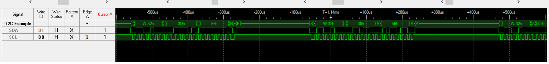

I am writing I2C commands to the device, and I see the commands go out, but the LEDs RGB connected to J5 in my schematic below never turn on.  I have the trigger button grounded, and in the datasheet it said if not used, ground it.  So I grounded it.

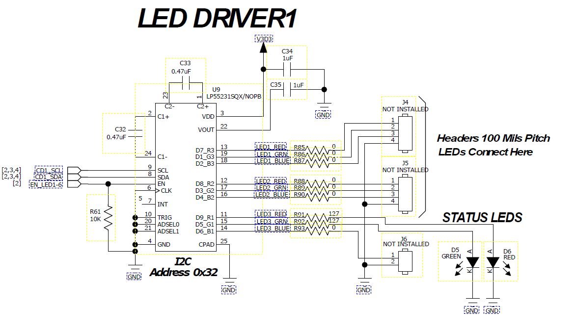

    Could you help to re-post your schematic? It seems died in original thread.
    And how you sent I2C commands, GUI or MCU simulation?
  • I don't know how to attach the image in this forum. I pasted it in the text area. If you send me an email, I can reply with the schematic section.
  • I have a microcontroller  i2c bus connected to the chip. I wrote c code to communicate with it.

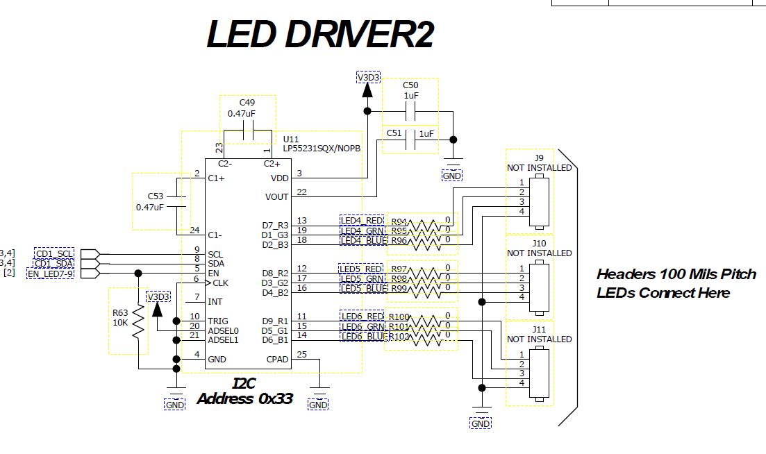

    The schematic I sent is for 2 LED drivers.  I have written C-code in a microcontroller to send command via I2C bus to the device.  I have a logic analyzer hooked on the bus monitoring the MCU to ensure the command reach the IC on its bus.  the image attached shows an example capture for some commands I sent.
    Here is some "experimental" code I wrote trying multiple things... the code is raw and I have not cleaned up comments, and I am using repetition command rather than doing it properly in the interest of saving time.  I need to understand few things.
    1. In the hardware the TRIG pin is hard wired to GROUND.  Is this a problem?
    2. The INT pin is floating is this a problem?

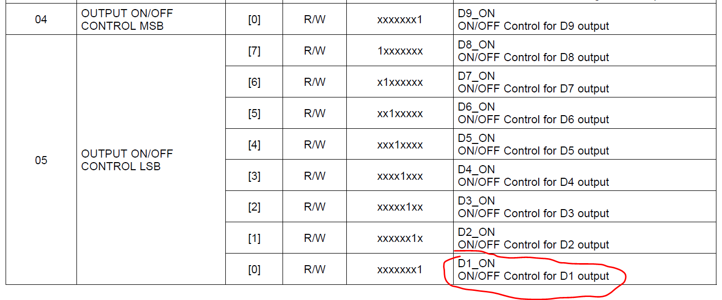

    3. What should be the proper sequence to turn on the LEDs?  All I want to do is just turn on a RED, GREEN, and BLUE LED connected to my custom hardware.   It would be nice to just have a pseudo code that show how to turn on LEDs without the intricate programs one can do on this chip.  I just want to Turn On, the red, then the green, then the blue.  That is all.  I am just trying to prove the hardware is good, and that the MFG house assembled the chip correctly.

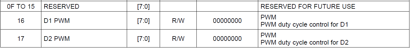

    -  I have tried to setup the current, the PWM register, I have initialized several register, and I can see the MCU writing correctly, but the chip is simply unresponsive.

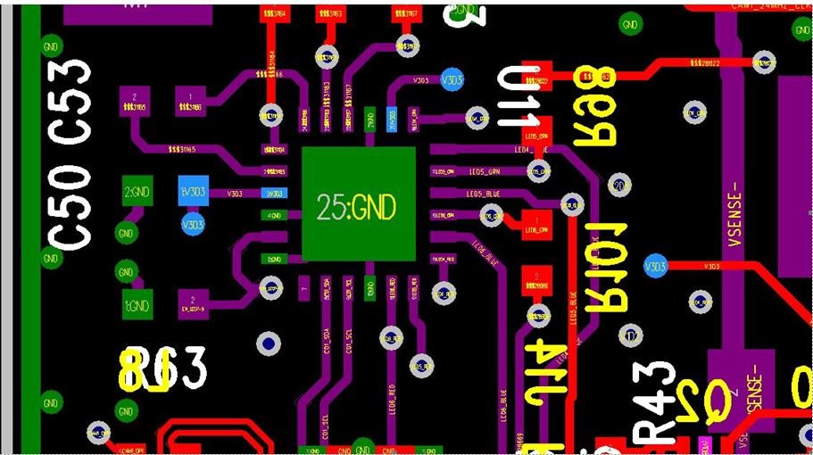

    - Visual inspection on the board shows the chips is soldered down correctly, yet no light comes ON.
    From my perspective, the LAYOUT is in order, the schematic fairs good with sparkfun breakout board using the LP55231, the only difference between this board and mine is the TRIG pin (which I am not using) being grounded, and INT pin floating.

    CHIP LAYOUT ON CUSTOM BOARD
    Not all layers are turned on, the ground planes, etc..  Only top layer (purple), bottom layer (RED)  The charge pump caps are in the opposite layer through vias.  Is this an issue?  Vias can handle up to 1Amp.  I imagine the switching frequency is less than 20MHz.

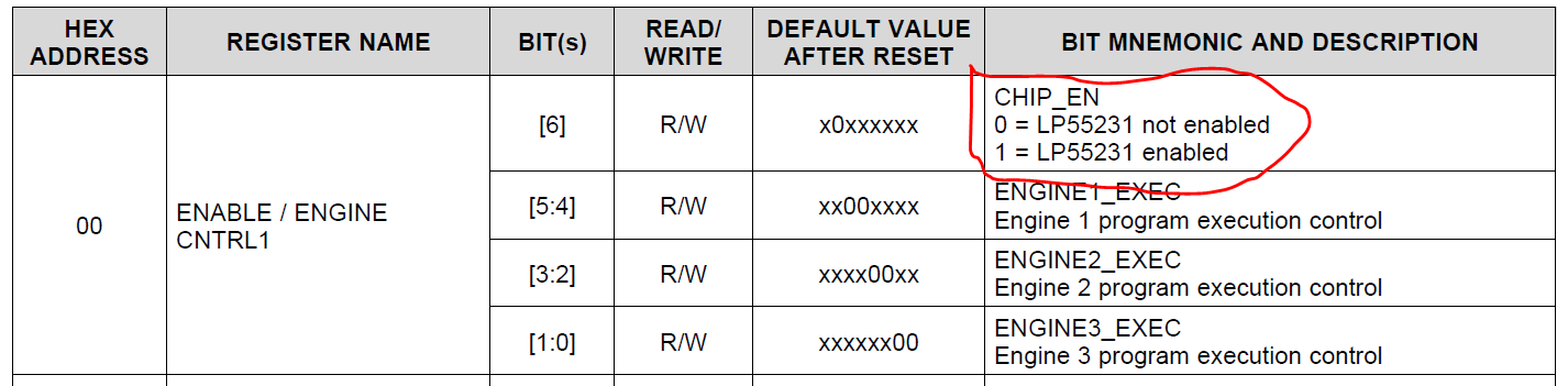

  • Hi Roberto,
    Your schematic and layout is OK. And it is also no problem to ground the TRIG pin and float the INT pin.
    Maybe there are some issues with power up sequence. Could you help to check your code is following as below? To light up the LED, CHIP_EN bit should be written high and EN pin should be turn high.
    The Start-up delay is 500 μs. Then set charge pump mode to 1x or 1.5x.
    After that, turn on the LED channel you want.
    Finally adjust the PWM and current bit to light up the LED.
  • Dear Hardy,
    I will try that and get back to you.  It is possible that all these addresses are not receiving the correct value.
    So here is what I plan to sequence
    Register -> Value
    0x00 -> 0x40 (0100 0000) LP55321 Enabled
    0x36 -> 0x18 -> for automatic control  I guess I will try 0x08 (for to bypass mode), 0x10 (x1.5 mode), and 0x18 for automatic mode
    0x05 -> 0xFF ->  I want them all ON D1 - D8

  • The datasheet shows table 3 with defaults but somebits are don't care. I suppose i will mask the don't care bits and compare.
  • Dear Hardy,
    I read the register and initially they read  0xFF, then I write only the register you highlighted, then I read back and the LED turn ON.  For some reason, if I don't read them first, writing to them won't work.  So I have to read them, then write them.
    For example I was turning on the RED.  Then I changed the code to turn on the Green.  The change won't take effect until I read all register, then write them.  This is bizzare why this is.  I was thinking the I2C bus capacitance was higher, and maybe the reading process charges the I2C lines, then writing them works.  So I changed the pull-ups from 4.99k to 2.47k and still the same thing.  It is not the pull-ups.  I put the scope the signals look good with a fast rising edge in both pull-up values.
    Why do I need to read them all and write them to make it work is a mystery.  I can't figure that out..
