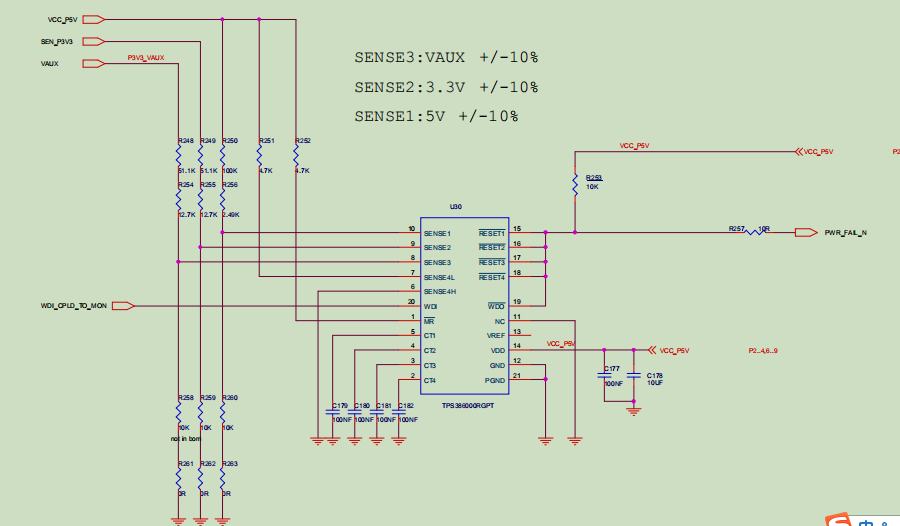

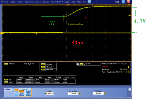

   when i sued the TPS386000RGPT,i found that the signal's rise of the WDI is very slow,as showing the flow figure
i just need the TPS386000RGPT for power monitoring,the power up sequence function is not need
the WDI signal is come from CPLD,the frequence is 500KHz,and the waveform is very good,but when it pass through the level conversion chip(TI,LSF0108),the rise edge is slow
i want to know,such this signal if can satisfy the TPS386000RGPT  use?
