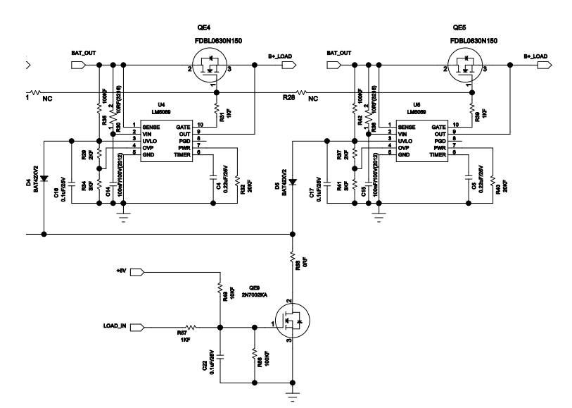

He use LM5069 as Load switch. Input voltage range is 50 ~ 80V , Output current is max 20A.
Schematic is here.
 Questions
 1. My customer use external current sensor. So he doesn't want to use Rsns. Is the schematic correct under this condition ?
 2. He doesn't use current limit function. Let me know how to set PWR pin resistance, Timer pin capacitance, Sense pin Connection and etc.
3. When Input is 50V, Output voltage is 50V and Vgs is 12V, But when input is 70V, output voltage 63V and Vgs is 3V (No load condition)
   As Input  rises above 60V, the Vgs  gradually drops. Let me know Why Vgs drops and How can solve this problem.

  • Hi Kim,
    Since it is high power design, I suggest to use the protection features of the LM5069 device.
    If you intend to use LM5069 as load switch, do the following
    1. Short Vin & Sense pins and connect to source/supply
    2. Leave Timer pin OPEN
    3. Leave PWR pin OPEN
    The GATE voltage drop is to the OVP trigger. Adjust the OVP threshold or disable the OVP feature and check. Also, check with load. If you still see the issue, please share Vin, Vout, GATE, input current waveform

  • Hi. Rakesh
    Thank you for your reply.
    And I solve gate voltage drop issue. when the gate is connected differential probe(ADP305), gate voltage drop occurs.
    In the opposite case, Output voltage operates normally.

  • Hi Kim,
    We have seen this issue of gate voltage drop when the gate is connected using differential probes. The impedance of the probe would effect the voltage.
    I suggest to measure GATE pin, MOSFET Source pin voltages using two probes and use math function in the scope to measure Vgs.
