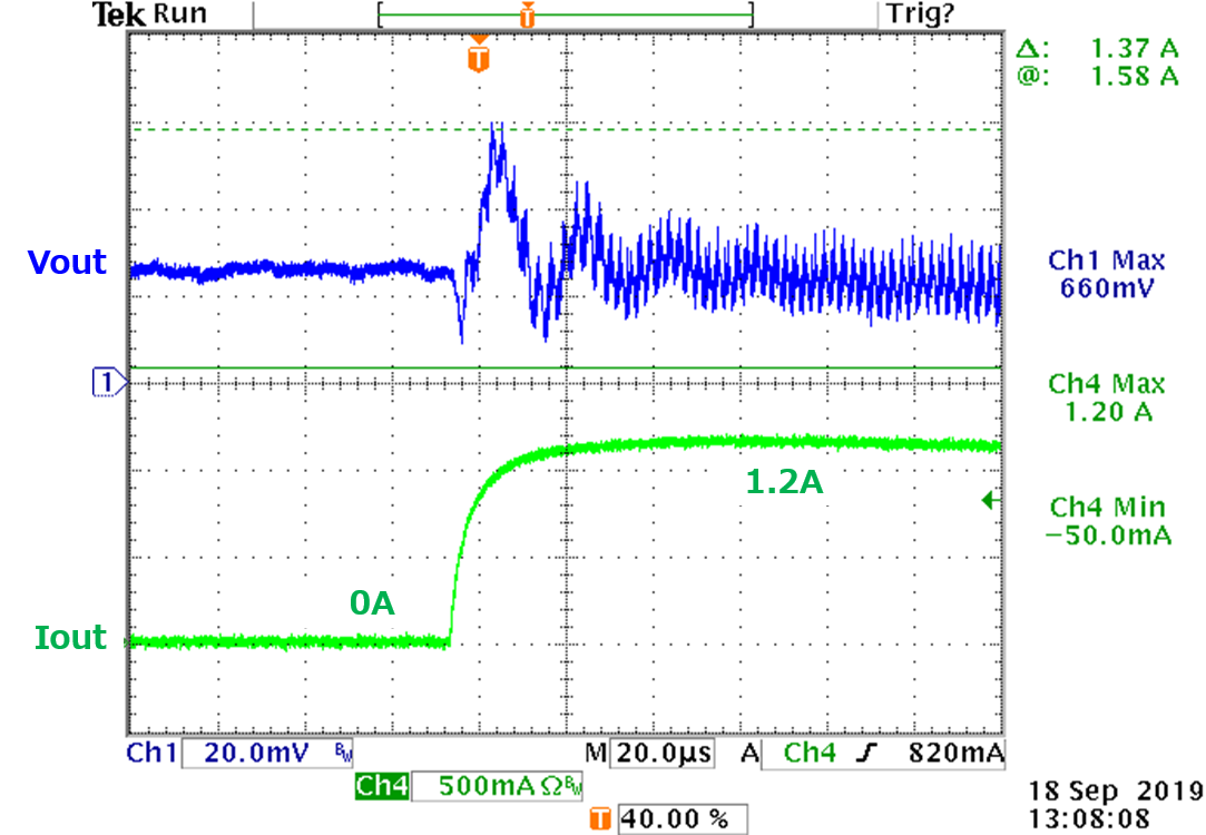

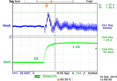

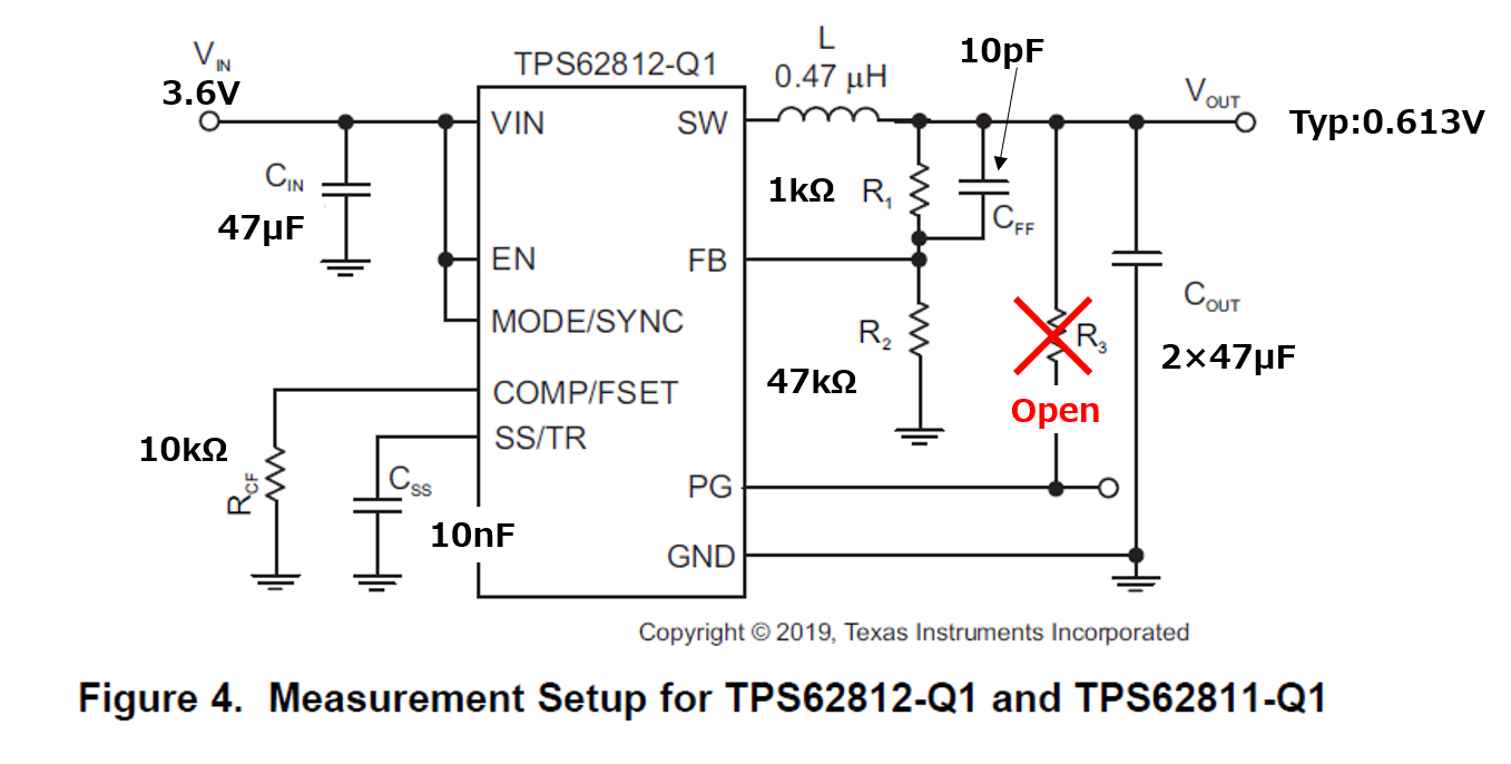

    I use TPS62180-Q1 as below figure 4.
    To set Vout = 0.61V, I chose the value of R1&R2 is 1k&47kΩ.
    In this condition, evaluating load transient, I got the result as below.
    When load current is increasing(0 → 1.2A), the drop of output voltage is small.
    However, the overshoot is big after the drop.
    Changing the value of Cff  (open, 10pF, 22pF, 100pF), the result is almost same.
    In Both PWM and PFM mode, the overshoot occured.
    Let me know how to reduce the overshoot.
    Increasing the output capacitance will make an impact on a transient response but there are other factors like slew rate, measurement techniques will affect the transient performance as well. Schematic looks ok here and would suggest checking measurement setup.
    App note provides more detail about measurement setup: http://www.ti.com/lit/an/snoa895/snoa895.pdf
    In addition, you can check the device performance on WEBENCH for the condition.
