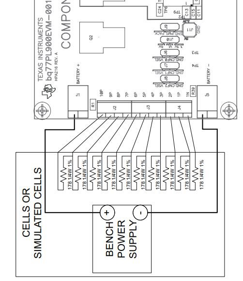

    You do not mention the individual cell voltages.  If the cell voltages are not provided by a resistor divider for the EVM or individual voltage sources or cells, the BQ77PL900 will turn off without PACK voltage.  This is the low voltage shut down feature.
    Apply cell voltages to the EVM and check operation again.  If the board was operated without individual cell voltages check the operation of the board to be sure inputs are not damaged since it is not certain how the 37V may have divided across the open cells.
  • Hi WM5295,
    Connected 180ohm resistors as EVM user guide recommend as below.
    Nicky
  • Hi Nicky,
    That connection looks correct.  With the voltages you described each cell should see 3.7V and the part should stay on.  The behavior you describe is consistent with the part seeing a cell undervoltage and turning off.
