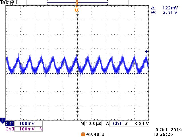

TPS62825EVM-794: When near Vin=Vout, the output waveform looks like oscillating
Part Number: TPS62825EVM-794
Hello, team.
I use TPS62825-EVM board with some parts value changing.
C1=22u
C2=22u
C4=no
C8=100u
R1=680k
R2=82k+56k
C3=100pF
JP1=1-2
JP2=ON
My setting is
Vin=3.7V
Vout=3.5V
I tried to watch the waveform of Vout when increasing output current.
But the waveform appears to vibrate.
Is this why?

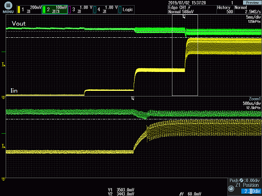

Vout and Vin
I have confirmed that it occurs near Vin=Vout.
Is there something wrong with my circuit?
    did you use the same inductor of the evm? Can you tell me how much is the output ripple? From the scope plot I have problem to evaluate it.
  • Thank you for your reply, and sorry my informattion was not enough.
    Coil is changed for "TFM160808ALC-R47MTAA ".
    When Iout = 1A,
      Vout ripple = 50mV
      Iin current ripple = 150mA
    Best regards.

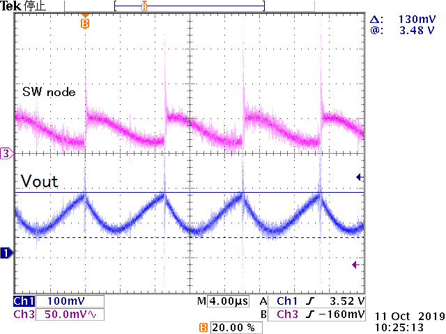

    Sorry for delay, I tested with inductance and capacitance in the d/s.
    the values are below,
    Inductor  0.47uH
    Output capacitance 10uF x2
    But, this phenomenon occurred.
    I can watch this wave when Vin=3.67~3.47V with Vout setting=3.53V, Iout=0.5A
    it seems that the device is entering in 100%mode and going out, in this situation you can have higher ripple as shown in your scope plot. Can you test gain the evm, including more input cap (to stabilize your input) and take scope plots of sw node to determine in which mode the device is running?

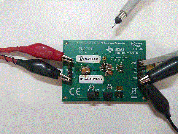

    currently I am out of the office for training and next week I will test one evm with your condition. In the mean time, can you please specify which kind of load do you have? Can I have a picture of your setup? I want to check the input, output connections and how do you test the output ripple and sw node.
  • Hello.
    Thank you very much for your support.
    Yesterday was our holiday, sorry.
    My setup is below,
    Oscilloscope ; Tektronix TDS3054
    C1=22u
    C2=10u
    C4=10u
    C5=no
    C6=47u
    C7=100u
    C8=no
    R1=680k
    R2=82k+56k
    C3=100pF
    Vout-GND = 7ohm (0.5A output)
    JP1=1-2
    JP2=close
    JP3=open
    Best regards.

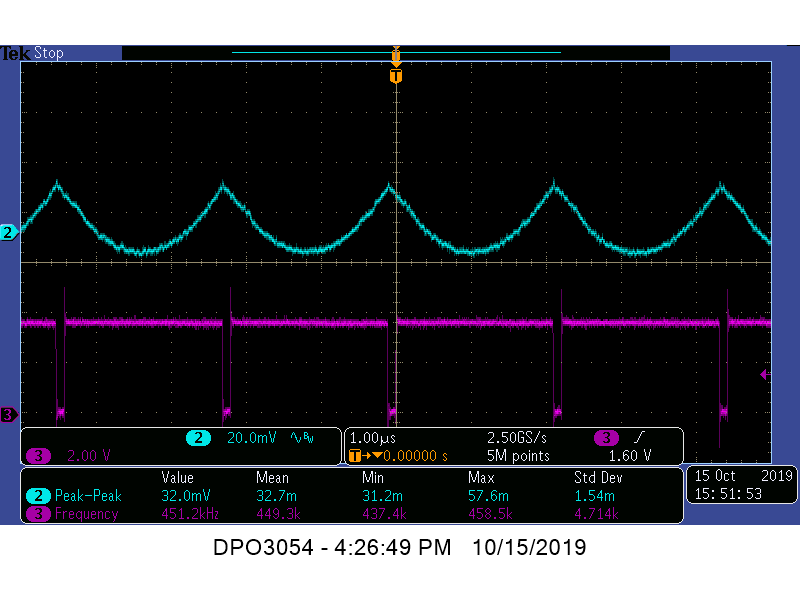

    I have some suggestion regarding the setup that you used.
    1) use short and twisted cable for the input and output (avoid crocodile and use different connector or solder directly the cable)
    2) tip and barrel method to meas the output ripple (meas across the closest output cap to the IC)
    3) test the sw node in DC coupling

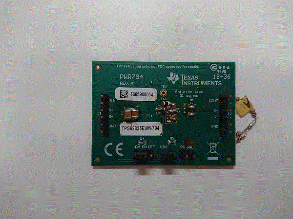

    From the pic I don't see well if you removed the input cap and placed somewhere else (if you did it is not ok).
    Do you have another clean board to test? If not try to clean it a bit (remove the excess of tin).
    Which power supply do you use? (maybe you can place at the input a big electrolytic cap to stabilize the input).
    I would like to see your input voltage, output voltage and switching node.
    I test the evm with you condition and this is my result:
