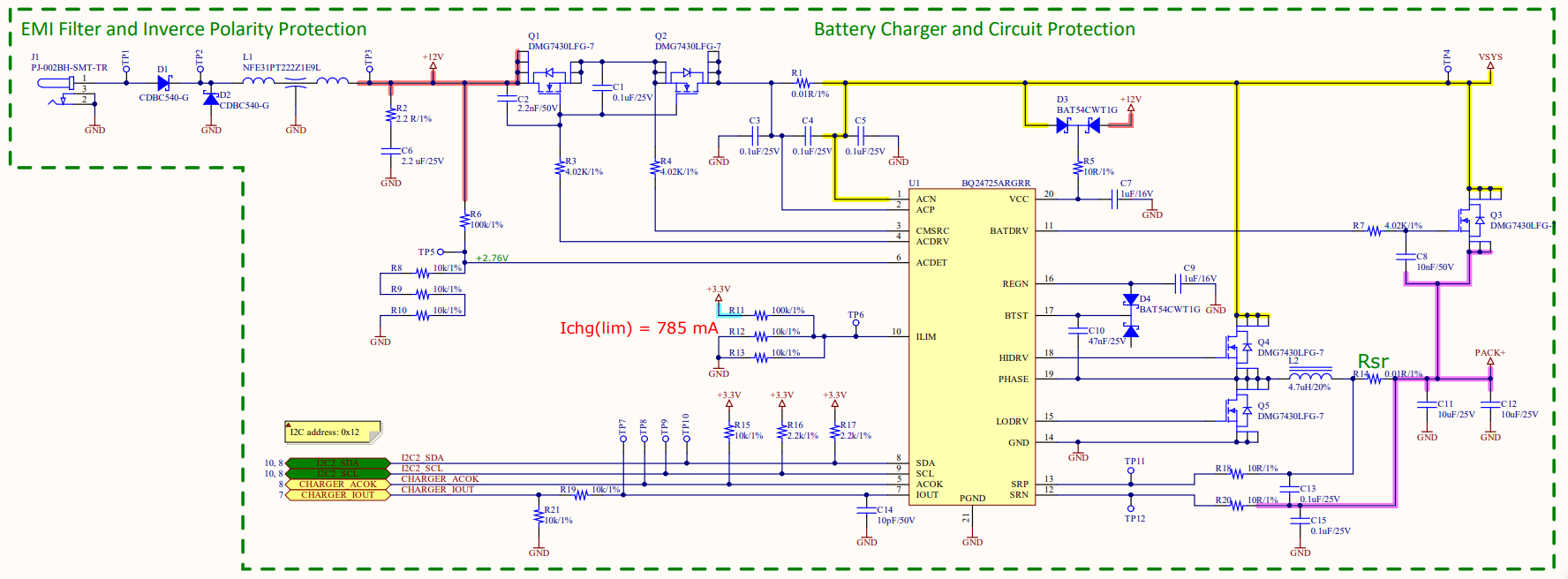

I build a board with the aforementioned IC which on one side has the adapter and on the other two cell battery. The system voltage is powering the Linux based system which is communicating with BQ24725A battery charger and BQ28Z610 fuel gauge over the I2C.
When the system is on the adapter with the battery attached, I am able to communicate with both the charger and the fuel gauge. But, when I disconnect the adapter at one moment, the system is able to communicate only with the fuel gauge but not with the charger. And they share the same I2C bus.
I have attached the schematic so if you have any idea for this behavior I would appreciate your suggestion to move forward.
Thanks in advance
Marko
  • Hey Marko,
    Can you measure the VCC pin of the charger when you do this test?
    Can you also measure the +3.3V rail of your system?
    I want to make sure that the charger is being powered through VCC and also that the I2C bus is pulled up adequately. The second item is less likely as you are able to communicate with the gauge.

  • Hey Marko,
    I would like you to apply 0.6V to the ACDET pin of the charger while you perform this test.
    The datasheet specifies that ACDET must be > 0.6V at least, and VCC > UVLO threshold in order for communication to be active. Currently, the VCC requirement is being met. Can you confirm that the ACDET condition is also being met?
    Joel H
  • Hi Joel,
    I have just performed the test and the procedure was as follows:
    1) Adapter IN, battery ON, ACDET = 2.7V, communication OK
    2) Adapter OUT, battery ON, ACDET = 0V, communication NOK
    Everything is clear now. Before we want to communicate with the charger, we should read the state of the ACOK pin and if the adapter is present then we can start communication.
