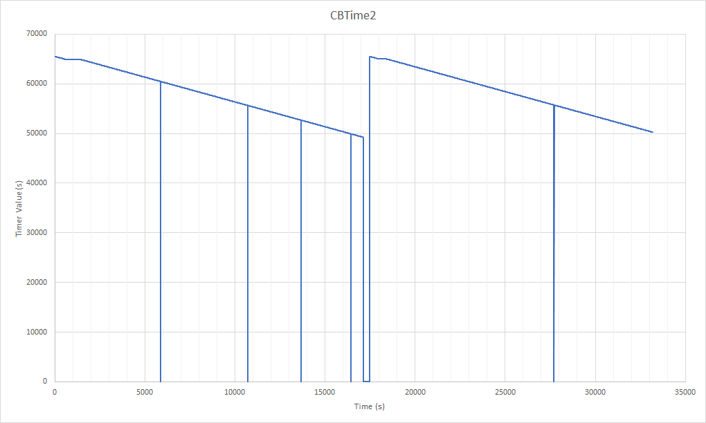

I have a few packs that were significantly out of balance when assembled.  Following relaxation, the balance action commences and runs for some time, but is interrupted before the Cell Bal Time would have time to count all the way down (from around 65000).
It's not clear to me why balancing is being interrupted - can you offer any advice regarding this?

    Here is a log of the CB timer value - it does get interrupted periodically, but now it now resumes.  This may be because I am now logging, preventing the gauge from sleeping, or perhaps it is because I have cleared the OCVFR bit as this can impose a 48 hour wait before another Qmax update can occur (it is a LifePO4 pack).
    I don't think it is the Relax Balance Interval (left at default value of 18000), as the interruptions occur more frequently - what else could be causing the interruptions?
    Jeremy.

    The timer is not expiring - it is being interrupted somehow, as below.
    I've charged the pack again and log again.
    Jeremy.

    I agree that the balancing function works and I have seen it steadily increasing the State of Health as balancing continues.
    However, I am trying to identify what is interrupting this function and if I can prevent this interruption so that I can balance more rapidly.
    I have attached an example log file that captures an interruption to the balance function.
    Jeremy.

    However, I'm still seeing CB action terminate unexpectedly, as attached.
    Please let me know if you have any further ideas on what might be triggering early termination of the CB action.
