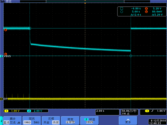

TPS65930 VBUS can't be driven to 5V immediately
as you can see in the picture,  as soon as the driver get the disconnect interrupt and finish the disconnection stuff,I drive the VBUS to 5V again. But it takes about 12 seconds to be "active".
The reason VBUS drops so slowly is that there is a big big capacitor on the VBUS, about 420uF.
