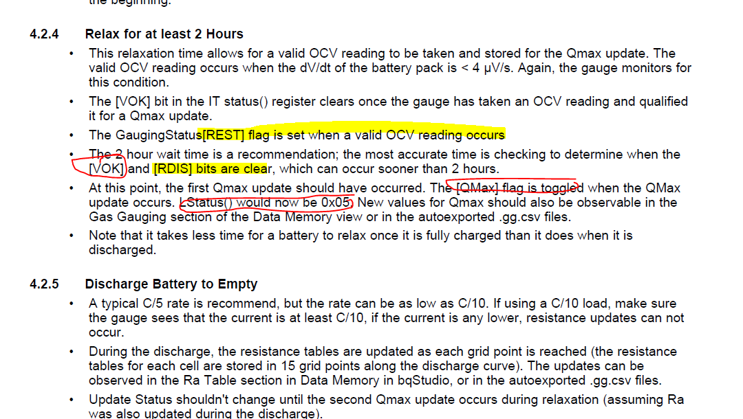

Me and a customer are looking into the Battery Charger: BQ40Z50-R2.
We follow the guide: "How to Complete a Successful Learning Cycle for the bq40z80".
Which states:
1. Discharge battery to empty
2. Relax for 5 hours --> Everything looks good this far
3. Charge battery to full
4. Relax for 2 hours --> Problems occur here

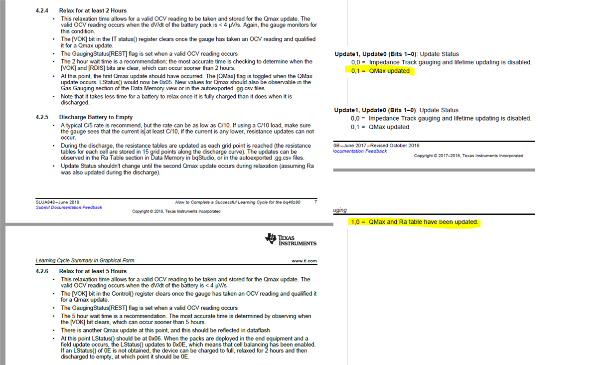

We cannot get clear the "VOK", change the "Lstatus" to 0x05 nor toggle the "QMax flag".
Are perhaps OC:s prohibiting the BQ to fully charge? Or what could be the reason behind the Lstatus, QMax & VOK.
I have attached 2 pictures illustrating the registers before and after, which shows that REST has been set.

    Please use update status in dataflash as as reference instead of LSTATUS. That is a more reliable indicator. You can send the zip file here for analysis.

  • Hi Lars,
    The update status is in the gas gauging: state section of the df.

  • Thanks Batt,
    Found it as you described it.
    As Kristoffer pin-pointed, if the Lstatus is skipped, is there any guide to follow to see if one has been able to complete a full learning cycle.
    The learning cycle process described in this document is used for guidance. http://www.ti.com/lit/an/slua848/slua848.pdf
    From 4.2.4 you might look on the update status in the “Gas Gauging” in the dataflash for Qmax as you mention earlier.
    Perhaps something like this you can interpret for 4.2.4 and 4.2.5 for the update status register in df, but for the last 4.2.6 remains how to see that.

  • HI Lars,
    In section 4.2.4 it would be reading update status in df where it will read 0x05.
    In section 4.2.5 update status should change to 0x06 at the end of dsg after Qmax and Ra are updated. It should be noted that RDIS should not be set during this dsg.
    If a relax-chg-relax-dsg-relax cycle is repeated again, you will have update status change from 0x06 to 0x0E.
