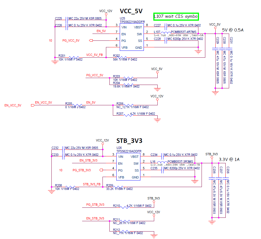

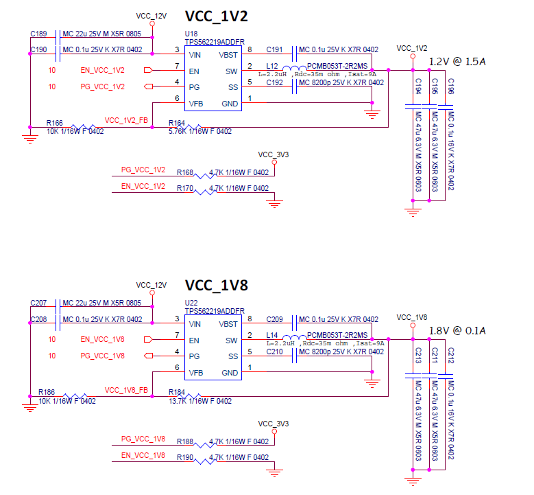

Customer and I just using the Webench to finish the below power rail design.
Can you check if you have further comments?

Kevin,
i am not sure why this was assigned to me, but I do not see any particular issue. Can I assume you have already researched the effective capacitance based on DC bias? 2 x 47 uF is nominally larger than the maximum recommended value, but with 6.3 V rated capacitors, the actual capacitance will be lower.
Dear John,
Thanks for the information, so other than that you didn't see other issues, right?
