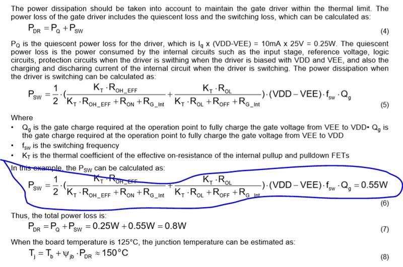

UCC21750: what's the value of Kt、Roh_eff、Rol?
Part Number: UCC21750
Other Parts Discussed in Thread: UCC21732-Q1
Hi
thanks.
  • Hello Max,
    This datasheet is still in Advance Information and is not fully up-to-date. Please see the released datasheet for UCC21732-Q1 in Section 9.2.2.5 for the up-to-date power calculations. These drivers have the same output structure.
