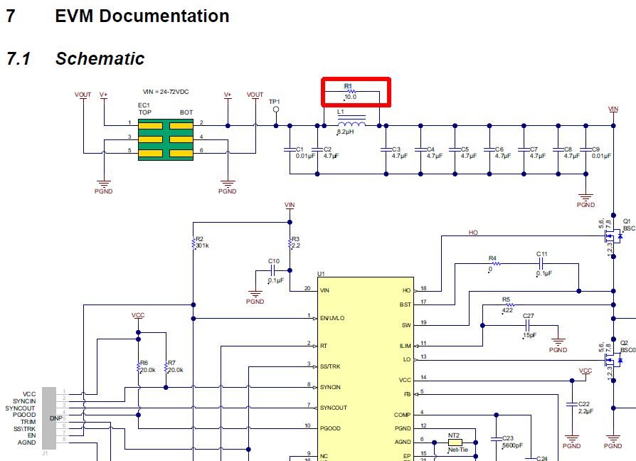

What is role of the R1 on the EVM?
Can it be allow to eliminate this?

Hi Kuramochi,
This L/C EMI filter tank has very high Q value as all capacitors are ceramic caps, R1 is added for proper damping to stablize the L/C impedance. another solution is to use electrolytic capacitor with big ESR
pls refer to below Application Note:
AN-2162 Simple Success With Conducted EMI From DCDC Converters
