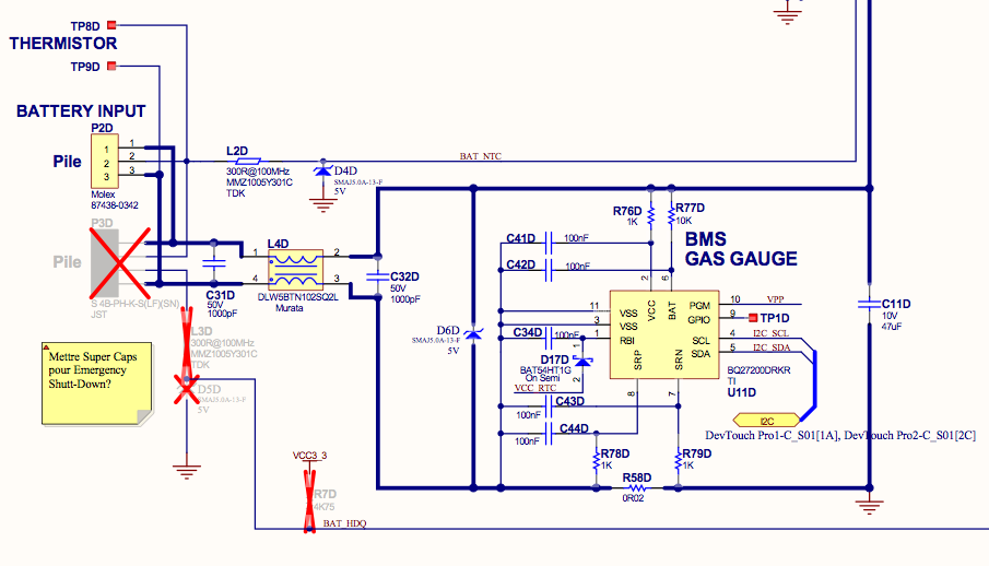

    Hi.
    I do not understand what yo mean by :
    "From your application, I have a question: You say you have a 3.0V battery backup with a 0.2V drop across a diode.  If we have 0.3V of ESD drop, then this would mean that Vcc could be down at 2.5V before we started to see significant leakage.  At this voltage, your over-discharge protection circuitry should be about ready to open up and turn off Vcc entirely.  When do your overdischarge protection FET's open up on your pack?"
    Below is the circuitry we use in our design. Can you explain your idea further ?
    Thanks in advance.
  • Pierre,
    I did some experimentation on my end to see how the actual hardware behaved, as this is not a typical application.  I found the following:
    During normal operation, there is a FET that is turned on that connects Vcc to RBI.  This charges the capacitor to back up the RAM if Vcc fails. If Vcc fails, this switch opens up, and the capacitor is only connected to RAM.  That means that switch opens up when Vcc hits POR.
    If you have a battery/voltage source on Vcc (through a diode of course), then as Vcc fails, the above switch actually begins to conduct in the reverse direction from RBI to VCC.  In this manner, the battery begins to power the part through RBI, and the RBI voltage never hits POR, so the switch does not open up, and the part stays on indefinitely.
    This means that if you used the above circuit, even after power was lost, the part is still on.  Since the part is seeing the voltage at the BAT pin to be 0V, it will assume that you have reached end of discharge, and it will set RSOC to 0%.
    Now, in order to fix this problem, you can do a few things here.
    1) Use only RBI cap/increase RBI cap size.  Using 0.1uF and the spec'ed leakage, the RAM should only last a short while.  However, we have observed that this is a gross underestimation, and we have found that using a 0.1uF capacitor can hold the RAM values overnight in most cases.
    2) Shift your source voltage from the battery to below 2V (Gauge POR voltage)
    3) Add a switch that only enables the battery connection to RBI after Vcc has been detected as 0V for a certain period of time (long enough for the gauge to shut down and turn off the RBI switch)
    Let me know if this makes sense and how you would like to proceed.
    Charles
  • We will most probably use a larger capacitor like 10uF on RBI pin.
    We may also use one or more regular silicon diodes instead of a schottky thus reducing the voltage at the RBI pin. The BMS IC may then be still powered for a while since it will receive a voltage slightly higher than 2.0V but it will switch to low power mode sooner thus saving backup battery power.
    The switch idea is a bit more complex to implement but we will think about it.
    The company for which we designed this product has decided to postpone any modification to the design to a future version. For the moment, he accepts to live with the small inconvenients caused by this bug. So, I will archive the great answers you have provided and use them for the next version later on.
