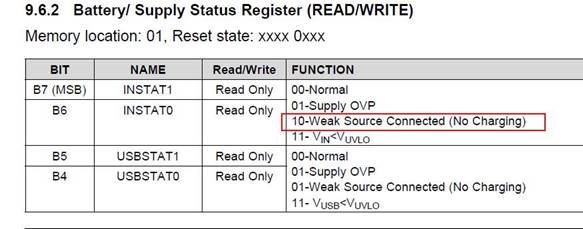

  • HI George,
    RE1: The weak source threshold referred to in the datasheet as VBADSOURCE = VINDPM setting.  If the input voltage droops to VBADSOURCE=VINDPM, input current is effectively reduced to 0 A.
    RE2:  There is no way to ignore VIN<UVLO.  To prevent inrush current from causing momentary droop you could try lower input current and/or charge current setting initially then increase in I2C later.
    RE3:  Deglitch for bad/weak source detection is 32ms.
    Jeff

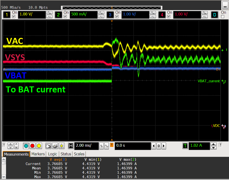

  • Hi Jeff
    We found the high inrush current when "start charge", higher inrush current with lower Vbat...
    Sometimes, the inrush current cause the input power as weak or bad source, then stop charging...
    Want to confirm with you have the soft-start between VAC&VSYS or VSYS&VBAT on bq24160?
    Any idea to reduce the inrush current? Any register setting to improve?  (Our charging current : 700mA ; Vindpm: 4.28V)
  • Hi George,
    The buck converter that provides SYS (and therefore BAT through the BATFET) has soft start at power up.  Bad source detect only occurs during the first 30ms after IN/USB rises above UVLO.  It does not happen when you enable charge or incur a load transient after power up.  Can you provide a scope shot of input voltage, input current, VSYS and ISYS when this occurs?

  • Hi Jeff
    The inrush current when starting charging and load by battery, as below figure, it seems positive correlation with the delta VINDPM and VBAT.
    So, higher inrush with lower Vbat...
    BR,
    George
  • Hi George,
    Your figure did not come through.  But, in summary, the IC will behave differently at lower battery voltages:
    VBATUVLO=2.5V < V(BAT) <VBATSHRT=3.0V - Icharge=ISHORT=50mA so I would not expect inrush caused by battery current
    V(BAT) < VBATUVLO=2.5V - No supplement mode so if your ISYS is large at power up, the battery is not available to supplement
    If the battery is above 3.0V then I recommend either disabling charge or lower ICHARGE at start up.
    Jeff
  • Hi Jeff
    The inrush current (from charger to battery) we measured is 1.5A when battery ~3.4V, and 1.1A when battery ~3.9V.
    (Charge current : 700mA, system load ~200mA)
    And the VAC voltage might drop to 4.1V sometimes, that would trigger the protection by charger and stop charging.
    That's the problem we want to fix.
    Maybe the volatge drop also relate to the output cap in adpater, however, we want to find out the solution by charger, and it is better to implement with SW solution(ex. register setting).
    Thanks.
    George
  • Hi Jeff
    I have attached the figure in before reply.
    Do you have any idea the improvement by register setting?
    Thanks.
  • Hi George,
    Can you modify the software so that
    1. charge is disabled at IN/USB attach
    2. charge is initially < 500mA then raise to higher later
    2. input current is initially < 500mA (or the lowest you can use and still keep system up) then raise higher later
    Jeff

  • Hi Jeff
    We still some questions about the weak source detection.
    [Q.1]
    1-a. 32ms deglitch time, this 32ms is used to confirm the input source is good source and keep >32ms?
    (It means the input should be > Vindpm(4.2V default) and over 32ms?)
    1-b. Or, 32ms deglitch time, this 32ms is used to confirm the input source is bad source and keep >32ms?
    (It means the input is weak/bad if Vin < Vindpm(4.2V default) and over 32ms?)
    Which description is correct for 32ms deglitch time?
    [Q.2]
    If description '1-a' is correct, the charger how to confirm the Vin is weak source? The mosfet would be turned off "once" the Vin<Vindpm?
    Thanks.
    BR,
    George
  • George,
    Regarding 1, if the source voltage is still below VINDPM after 32ms, a weak source is detected.  This gives time for transient dip to correct itself.
    Regarding 2, n/a since 1b was correct.
    Jeff
