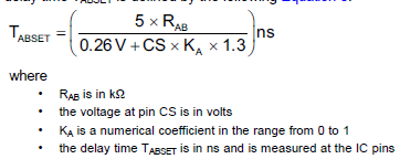

I have selected UCC28951 IC for my DC-DC converter requirement. I have a confusion in dead time calculation.
the above-mentioned equation is given in the datasheet.
RAB = 15 k
CS = 1
Ka = 0.5
I am getting value like 82417 ns, but in datasheet is 90ns.
Please let me know where I am doing mistake.
