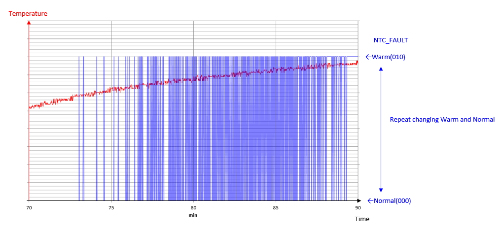

NTC_FAULT changes frequently at the temperature where the rise and fall overlap in the temperature range of JEITA Thermistor.
For example, since 45.1% to 45.8% overlap in T3, NTC_FAULT changes frequently between Normal⇔Warm as shown below.
VT3_Rising: 43.8-45.8%
VT2_Falling: 45.1-46.2%
Does this behavior correct?
