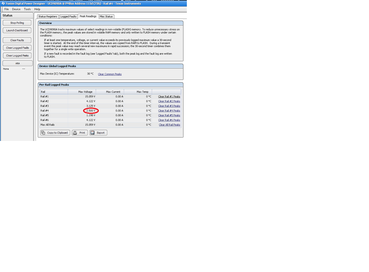

    I spent more time on the Fusion GUI.  As mentioned before, the Fusion GUI reports correct voltages for all rails while "polling".  I also confirmed the correct voltages for all rails with either scope or multimeter.  However, on Fusion GUI, under "Status" and "Peak Readings", Fusion logged all the high peaks, identical to how we retrieved from PMON logs in our SW.   I have attached 2 files for your reference.  I circled the fourth rail for simplicity.   We have high peaks on all except Rail #5 on the first PMON.
    We are on the same page that at one point, those rails have been recorded at such high voltage, and parts are still functioning.
    Again, could we somehow getting erroneous readings from Fusion tool?

  • Hello
    Have you checked the logged fault under status? are there any OV(OVER_VOLTAGE) faults reported on those high peak rails?
    Have you had the fault response set for OV event? if so, rails shall be off due to a OV fault.
    Please share you project file so that we can review.
    Yihe

  • Hello
    Have you ever clear the fault log or peak log? How long has the device being run?
    If you clear the peak log, will the similar peak value be back? I checked the project file and they seems ok except that you do not have fault response set. If there is any OV or UV faults, device will continue running.

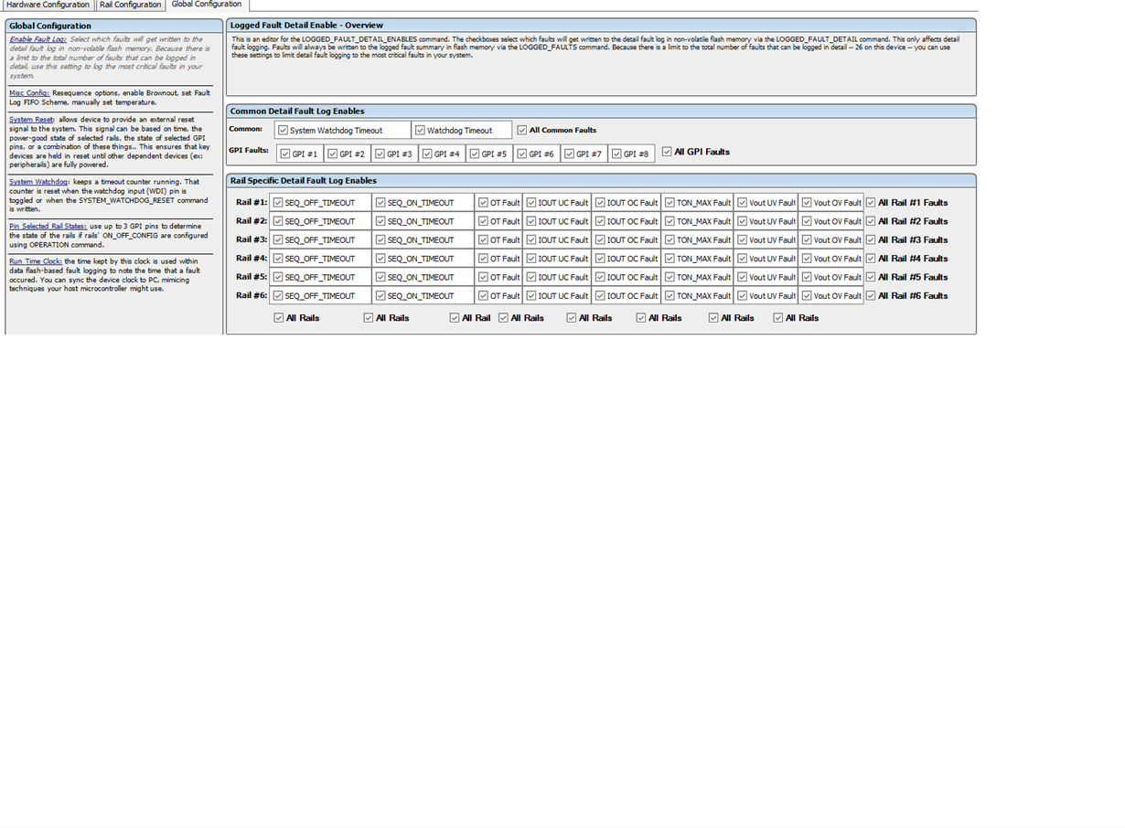

    Once I clear the peak log, I will not see the peak again.   Regarding the OV or UV faults, we will get the logged faults if any fault occur now, but nothing on that very first record.  In the project file that I sent you, under Global Configuration,you will see that we have enabled all Faults.  This is how we configure it.  Would you check?  Below is cut/paste as well.

    Regarding the Fault Responses, you are right that we did not configure the Fault Responses.  We are able to get OV faults, UV faults, etc with all Faults enabled in Global Configuration.  What is the difference between setting in Fault Responses and Global Configuration?  Why isn’t what we are currently configured efficient?  We will look into the Fault Responses but we’d need to have more information from you. We’d definitely interested in improving our PMON monitors.  Please advise.
    Yen
  • Hello
    now you have cleared the peak log on board #1. could you let it run and not clear any fault and peak log to see whether the high peak will be back?
    Fault response and Fault enable(at Global configuration) are different functions. The fault enable is to enable the logging for the fault event so that application can retrieve the fault information afterwards
    Fault response is to set the action taken by the device when a fault event is detected. For example, if any rails have a OV/UV faults, you want to shutdown all/partial rails to prevent any damage, the fault response is the way to help you.
