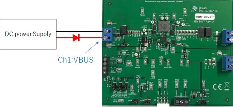

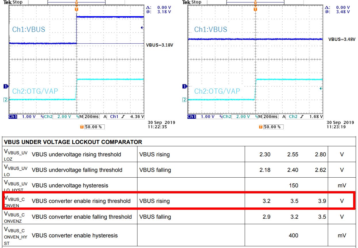

Please let me ask about VBUS condition to enable OTG. In page 24 of datasheet, it describe "VBUS is below VVBUS_UVLO" to enable OTG, but I think that it may be VINDPM threshold, not VVBUS_UVLO. Can you confirm it by using EVM? I actually confirmed it by using EVM on my bench.
