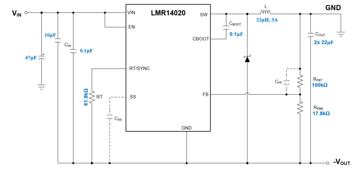

    Can I use the synchronous buck converter to do the inverting buck design like the design I do in the picture? if not, could you please explain why?

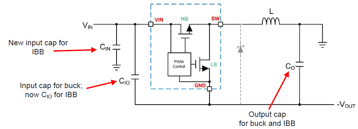

    I am sharing TI app notes with you, which will greatly help you to understand the designing of Inverting Buck Boost through any ordinary buck converter.
    http://www.ti.com/lit/an/snva856/snva856.pdf
    http://www.ti.com/lit/an/slva478b/slva478b.pdf

         The document you shared mentioned that "Finally, the "new" input capacitor from VIN to system ground helps to provide a low impedance path at the"(snva856.pdf P10).However,  I still don't understand why there is a the "new" input capacitor in IBB. Could you explain more specifically the reason why the"new" input capacitor exists , or what damage could happen without this the "new" input capacitor ?

    This new input cap exists to take care of all high-voltage ripple caused by PCB resistance and inductances that disrupts the electronic devices, whereas Cio will help with load transients by providing a path from input to output for the load current transient.
