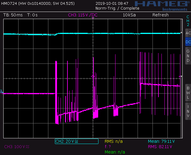

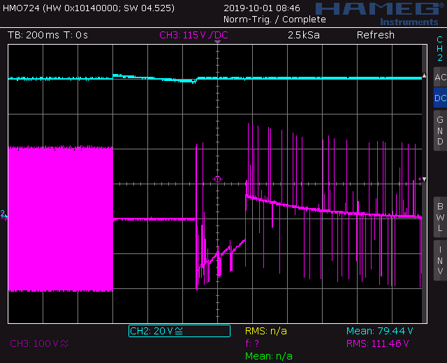

    Now, testing the no load condition, we see this behavior of transient from full to no load.
    (Blue = Output voltage, Pink = Lower Mosfet VDS)
    After this transition, that lasts 300ms, burst mode is entered.
    Do you have any suggestion to limit this transient condition?

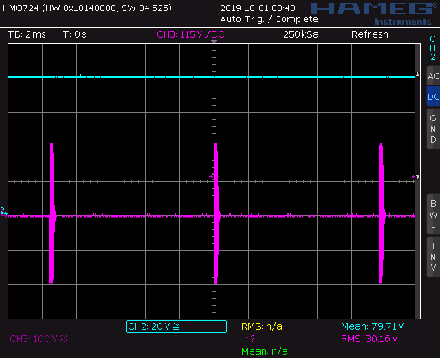

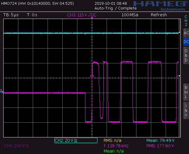

    In addition, if we zoom the burst, we see this:
    Do you have an idea of the reason for such behavior? Is it correct?
    Many thanks,
    Francesco.
  • Hi Francesco,
    The controller will stop switching when going from heavy load to no load. This is to limit the max overshoot in the output voltage. The switching pattern when the converter resumes switching looks interesting but I would say it is likely the result of the low sampling rate of the scope in the first two plots. The third image shows the converter operating in burst mode. It looks normal. The fourth image shows the high side gate is slightly delayed in turning on which results in the switch node resonating back towards primary ground. This can happen if the controller misses slew rate detection. You could try minimizing any snubber capacitance that is on the switch node, reducing the MOSFET gate resistance or reducing the magnetizing inductance slightly to help improve the slew rate detection reliability.
    Ben Lough
