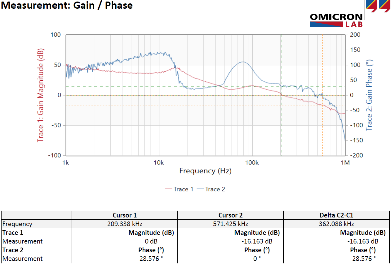

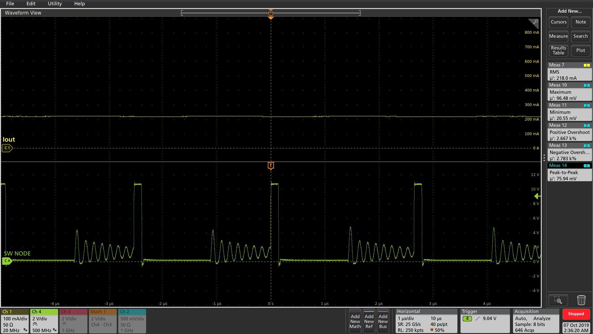

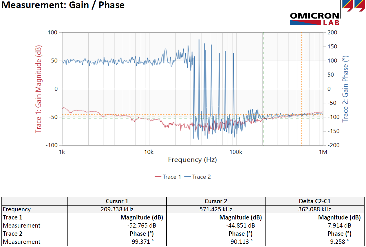

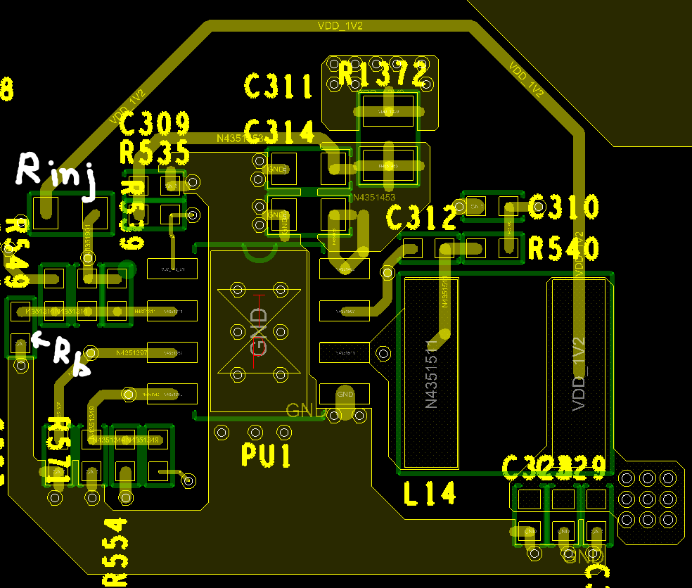

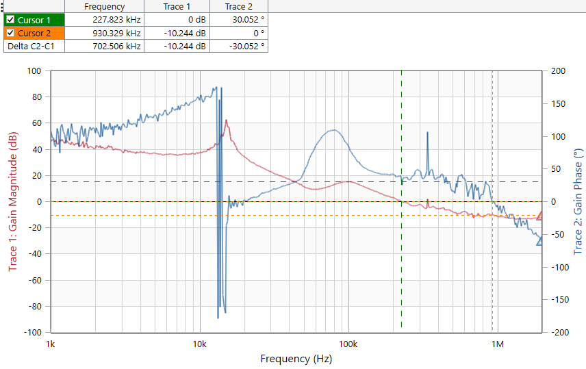

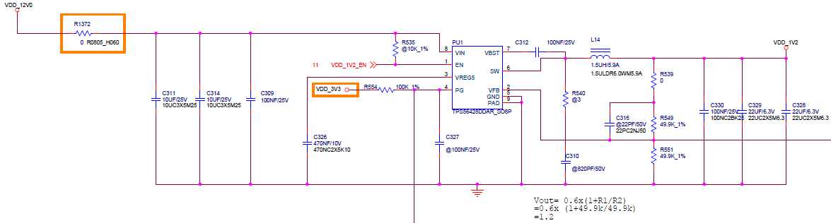

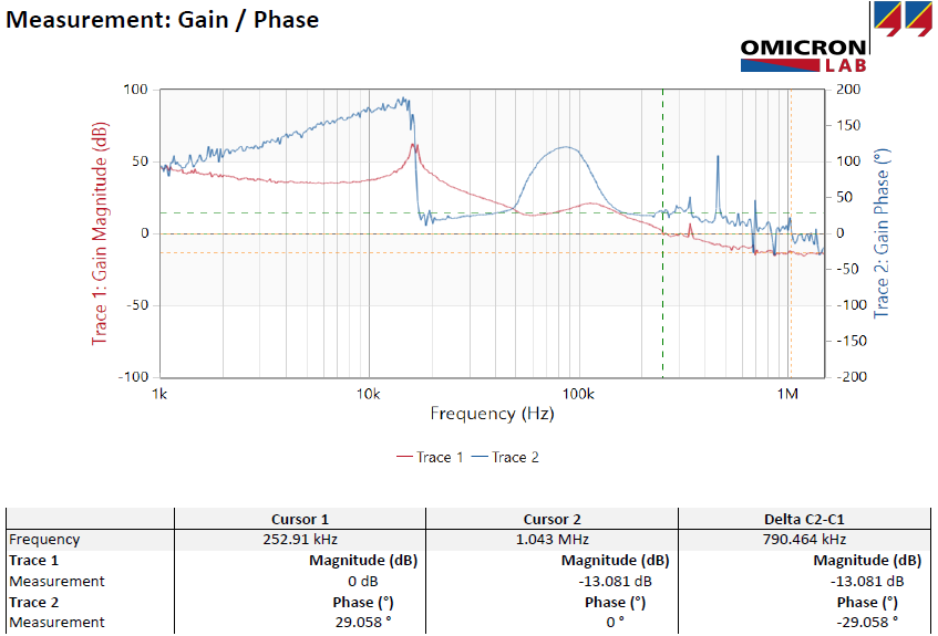

Attached is our shcematic and bode plot measurement result of TPS56428.
Electrical parameters as list below.
Vin=12V
Vout=1.2V
Iout_max=3A
injection resistor=10ohm / source level=-20dBm
I have try to add feed-forward capacitor(47pF) to increase the phase boost. But, it doesn't work.
Do you have any suggestion to solve this issue? thanks.
