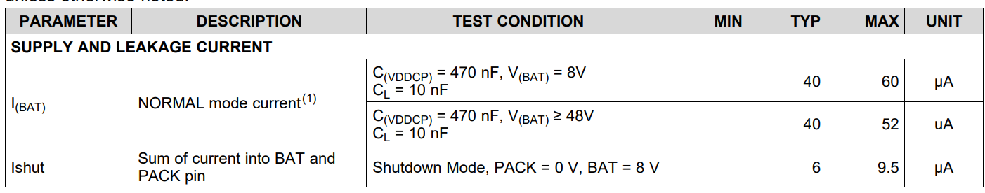

What should the current be flowing through the PACK pin on this part?  The datasheet states what the current is for the BAT pin, but I didn't see anything on the PACK pin.
See above, only shows the shutdown current for BAT and PACK pin.
Thanks, Mike

    There is not a characterized current into the PACK pin.  It is generally much less than the BAT pin, however in certain modes it is large.  See http://www.ti.com/lit/pdf/slua794 figures 7 and 8.

  • Hi Mike,
    Normal I(BAT) shown in the data sheet is 40 uA typical, so your 50uA seems in range.  Current and pulse frequency will depend on the load on the FET gates.
    The pack pin current will depend on the inputs.
    PCHG_EN has a pull down internal, so floating is OK, pulling down may be better since you know nothing couples to it then.
    PMON_EN connected to VEN is likely the cause of your PACK current pulses.  VEN is a periodic signal.  Even with PACKDIV open the part draws significant current internally from the PACK pin to bias the internal switch.  Most of the current is in the switch biasing, the current out PACKDIV is small.
