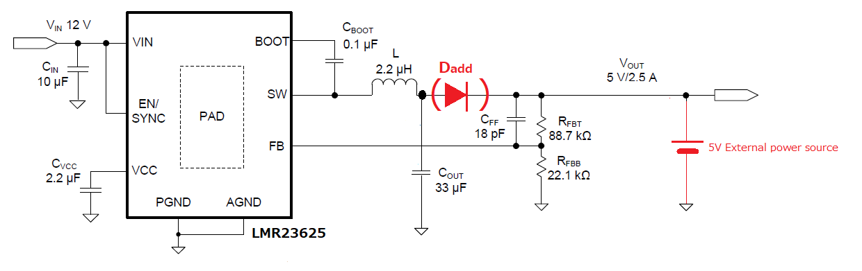

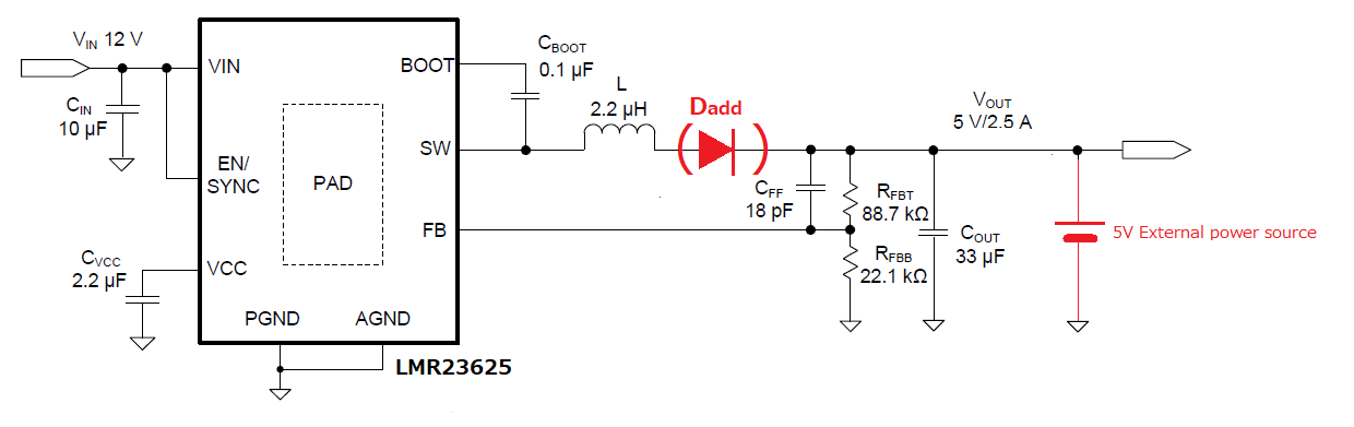

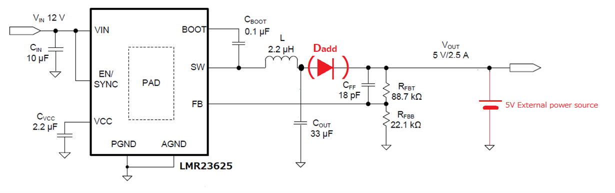

Dear Team,
I am designing circuits using LMR23625.
My circuit has a external power source and the output is connected to Vout of LMR23625.
When Vin=0[V] of LMR23625, Vout(+5V) voltage of LMR23625 is 5[V] by the external power source.
1. Can I insert Diode(Dadd) in the attachment diagram for protect of LMR23625?.
2. Is there a problem about LMR23625 when there is not the diode(Dadd) ?.
3. Is there the method to recommend to protect for LMR23625?.
