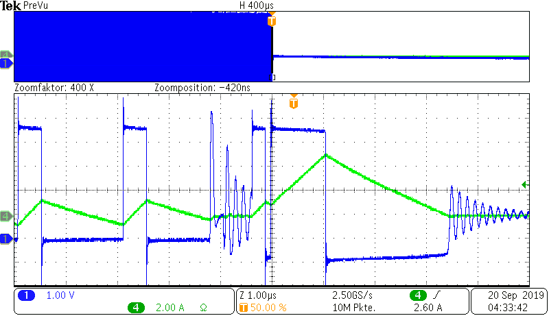

i have a circuit with this DCDC-Converter for an output voltage of 1,0V. I have also many other circuits with higher output-voltages ( 1V8, 2V5, 3V3 ) all from a VIN = 5,1V. Only some circuits with the 1V0 output make troubles ( after many power-cycles the switch-node is shorted to ground -> internal BOT-FET is shorted ). The circuit of the 1V0-Converter uses a 0,8uH-Inductor, all other circuits uses a 3,3uH-Inductor. I have made many measurements at the power-up and power-down ( plug-off ). Sometimes at the plug-off-state, i can see a huge increase of the inductor-current, although the controller has been disabled with the Enable-Pin. I have attached the circuit and this measurement.

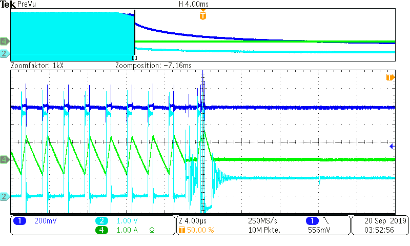

    Can you explain a bit more what you mean by power-down (plug-off)? It doesn't seem on the second graph that the output is disabled.

    From older measurements, which i have attached, you can see how the output voltage will fall after power-down.
    CH1...1,0V Output
    CH2...SW-Node
    CH4...Inductor-Current
    In this following picture, you can see the state if the Enable-Pin has been pulled low to disable the controller. You see the last few switching-cycles, but the enable-pin is set to low at about -3us before triggertime:
    CH1...SW-Node
    Be aware that this pictures are not the same triggerevents, but the same pcb and test-setup.

    I think here we need to focus on enable signal itself.
    The raise of the inductor current is induced because the switching still occurs.
    Could you tell me what is the use of D19 ?
    As you can see in topic 7.3.7 of Datasheet (Enable and Adjusting Undervoltage Lockout), we don't recommend the use of any diode. I think it might bias the voltage that EN sees at its input.
    Were you using this diode on other TPS54618 in your system?
