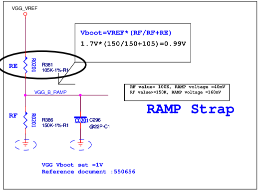

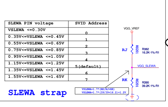

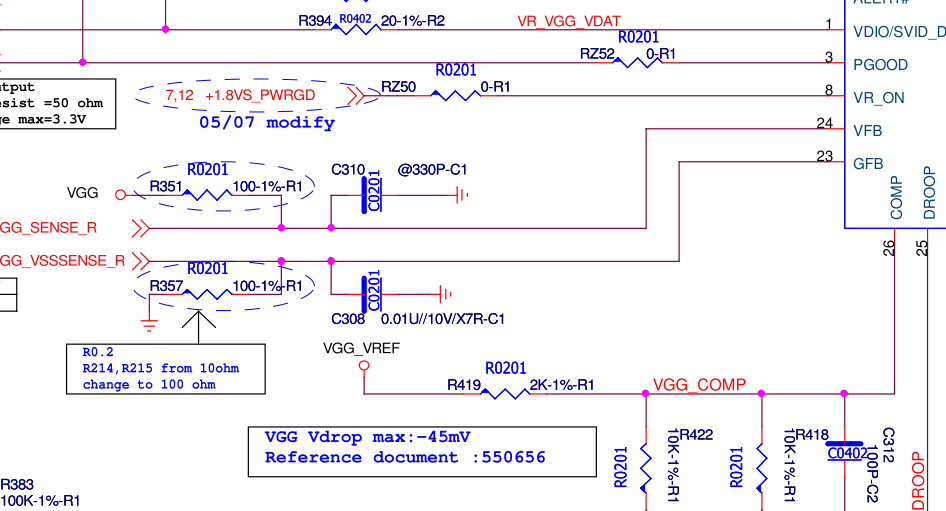

Our customer used the TPS51623 in Intel BRASWELL platform,
The VGG is Design Vout=1.2V. But TPS51623 Measure Vout=1.137V.
Customer tell me change the IC the Vout is OK. and have 10% fail rate,
I am confused, I think not IC issue.
Can I measure which side to clarify the problem?
as below is measure result.
Pin15(SLEWA)=1.206V
P27(VREF)=1.696V
Pin24(VFB)=1.137V
CPU monitor point =1.137V
PWM=800kHz
