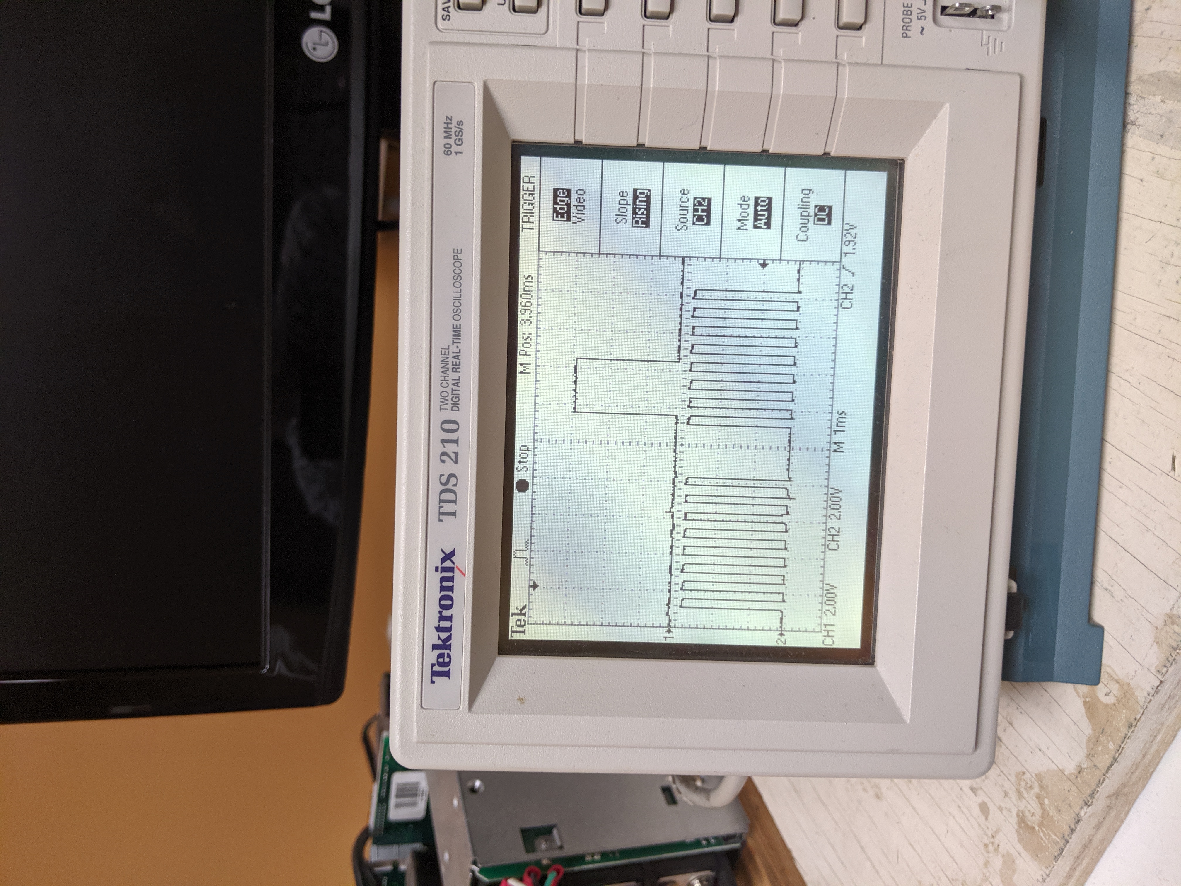

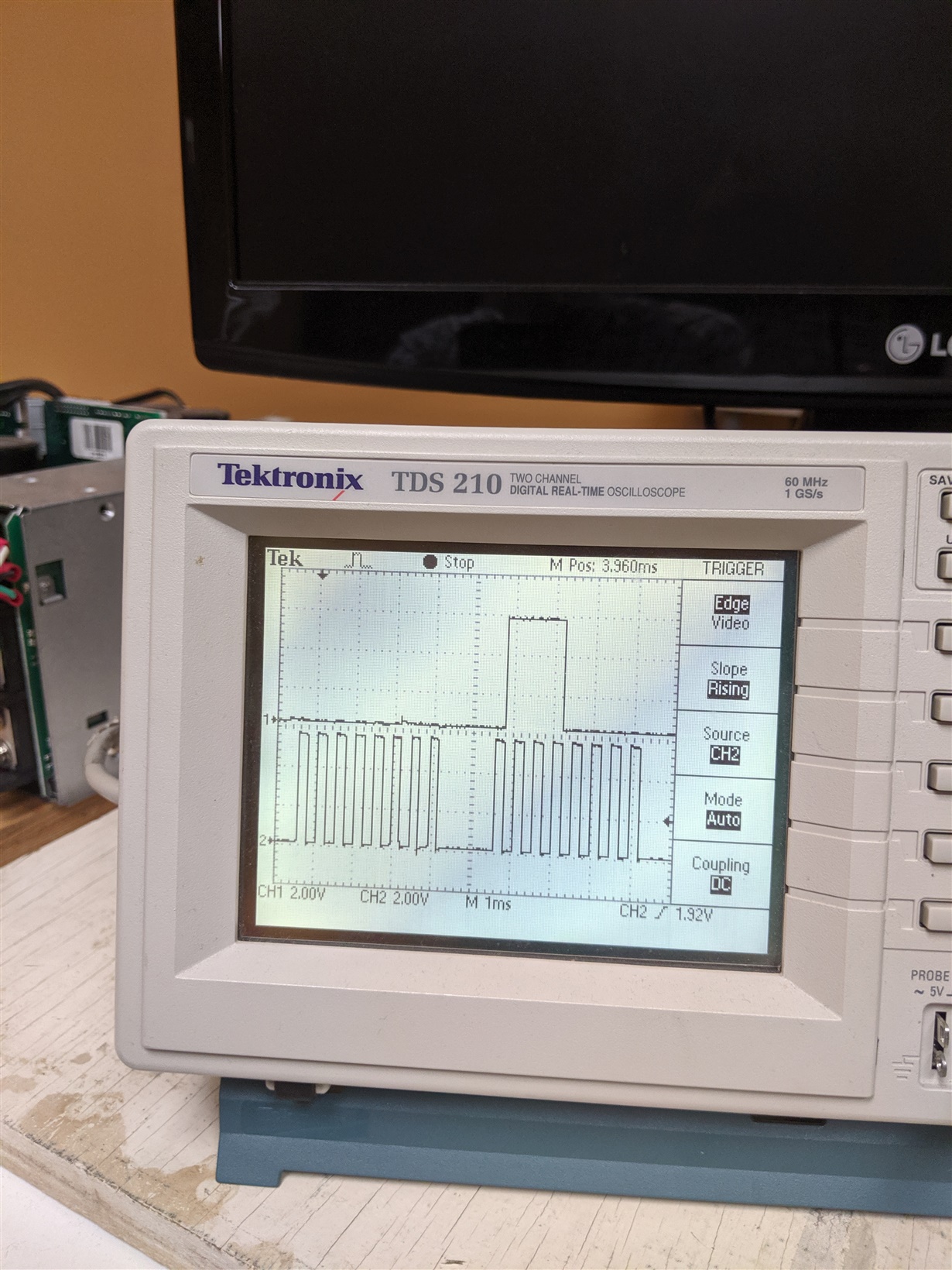

    However, I am getting an error beacuse fault INT goes high. The SDO signal is attached. The top trace is the SDO (MISO) and the bottom trace are the clock pulses. The first 8 clocks cycles are the chip select to the SN74AHC595QPWRQ1 to select the EMB1428. The next is SDO for the command to turn off the EMB1428, hence the 0 in the command portion of the message.
    Have I interpreted the SDO pulses correctly? It says "EMB1428 will drive SDO on the falling edge of SCLK", and I  interpret  the fault to be b1110. Which according to table # Fault codes is DIR_RT is not the opposite of DIR
    Is my interpretation correct? Also, there are no over or under voltages errors in the registers that are read.
    Malcolm

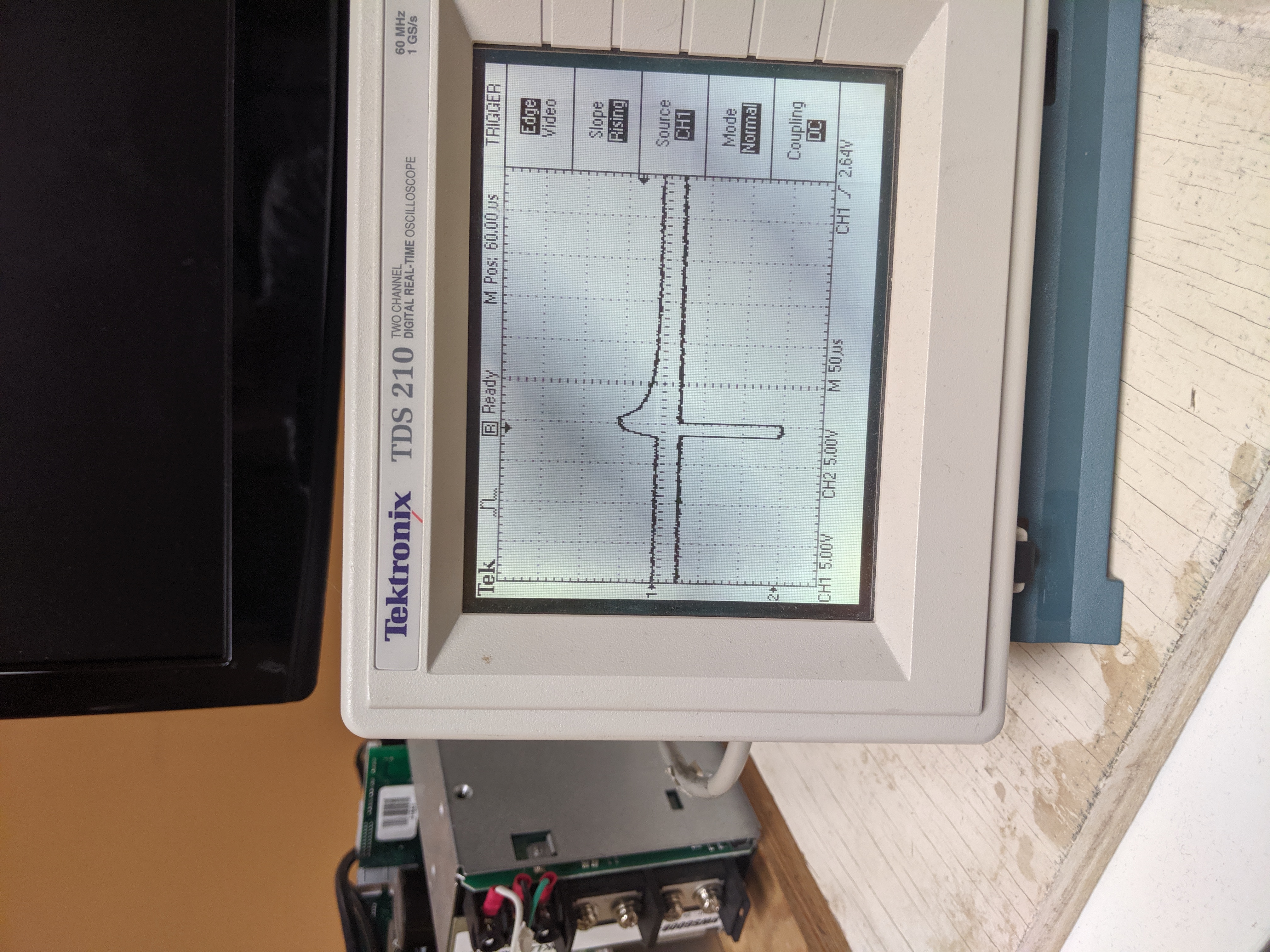

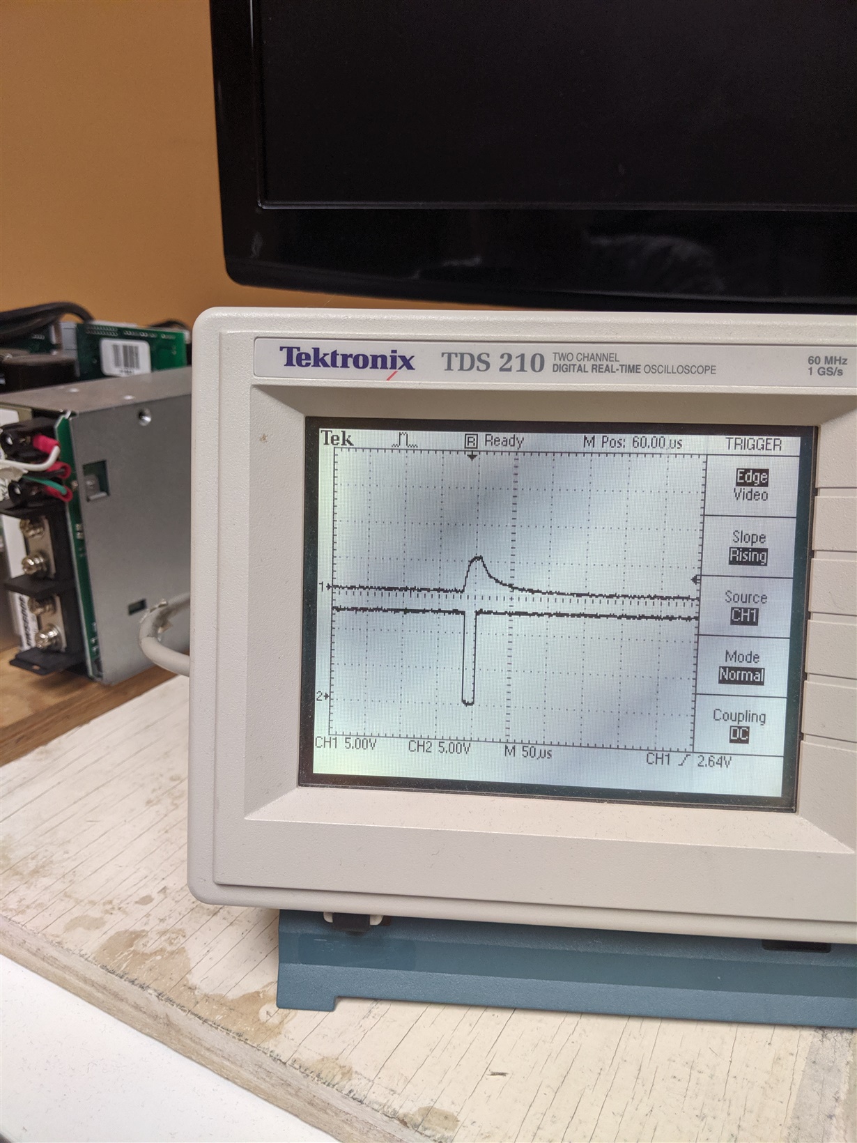

    After a little more investigation /reading the fault appears to be b0111. I don't see this fault listed in either of the datasheets  (EMB1428 and EMB1499).
    The FAULT_INT is always triggered to what I believe is a Done went high while EN was high. See attached.
    Any thoughts on what might be happening ?
