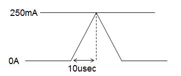

Load transient response
Iout : 0A to 250mA for 10usec (25mA/usec)
Cout : Currently 4.7uF//4.7uF are connected
Vout range : 1.8V +/-5.0%
